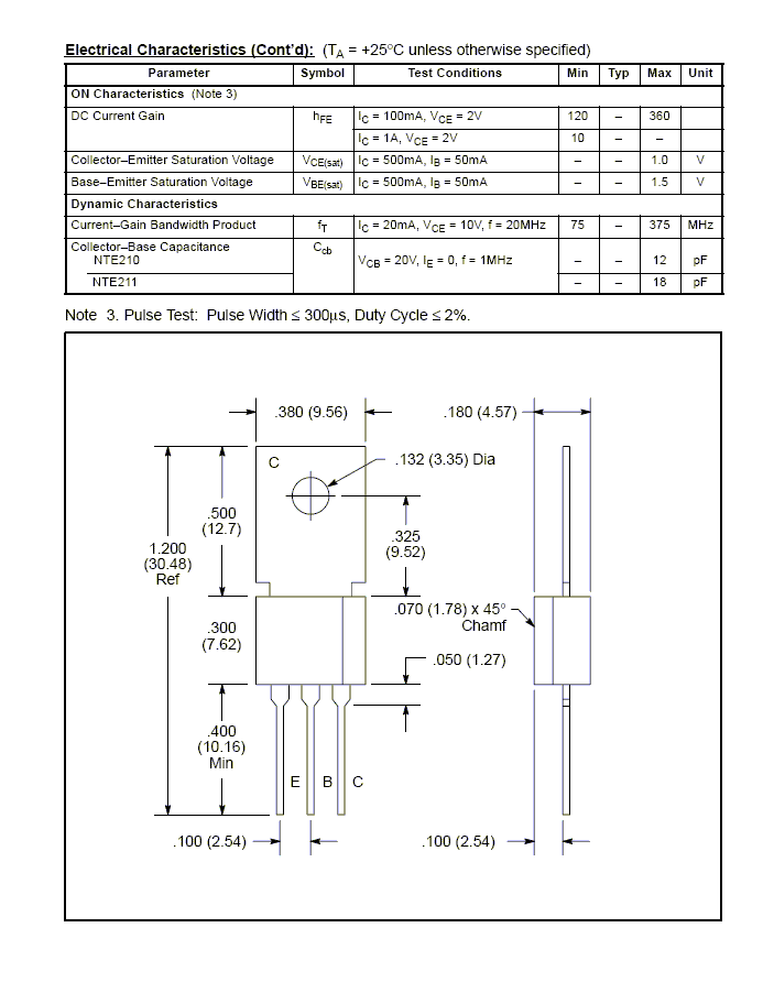

Overclocked Member Jan 4, 2006 #1 Its a Transistor and I can seem to find the data Sheet (I think its a transistor) Its like a T0-220 Package, but the part that mounts on the heatsink looks a bit different. On It has Written 311/NSDU05 (that 0 is either an O or 0 ) and has marked E B C near the pins

hotwaterwizard Active Member Jan 6, 2006 #2 It crosses over to NTE210 Attachments nte210.pdf 22.6 KB · Views: 269 nte210_pg2of2.gif 26.3 KB · Views: 381 nte210_pg1of2.gif 35.9 KB · Views: 389
