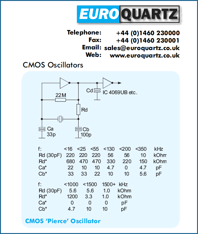

Hi Len,
See if this would helps. Rd(30pF) is for conventional crystal so Rd* would be for miniature crystals.

Thanks for the responses, but as I said in the original post, the 16F84 data sheet states that a series resistor is necessary, presumuably as too much drive power may shatter the xtal.
The post by L Chung tends to support this.
Len

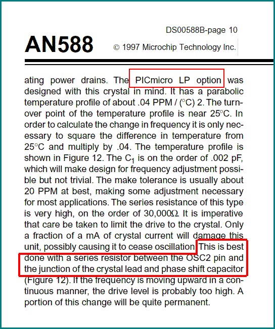

Mike, you may be right. I have the Microchip 16F84A "preliminary" data sheet DS35007A.
Page 22 under the heading of 6.2.1 Oscillator types Figure 6-2 shows the series resistor RS. But on re-reading note 2 the resistor "may be required for AT strip cut crystals"
However, the crystal I have states a max drive of 1 uW. So I would like to check the drive power.
