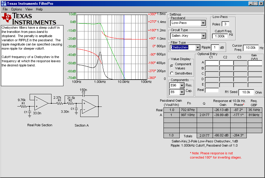

I'm trying to make a 3rd order rc filter but i cannot find a calculator that will calculate the corner frequency is it the same as a 1st order? also what is the disadvantage of a third order over a frst order
You should be designing an active filter. Filterpro from TI can be used to design those. Passive higher order RC filters have very poor characteristics and are usually not used.
Don't quite understand your question about the corner frequency. The corner frequency is usually the -3dB point on the filter roll-off, independent of the filter order.
The disadvantage of a 3rd order filter is that it's more complex than a 1st order filter.
A 3rd order filter requires two opamps. You might as well make it a fourth order, which also requires two opamps.

I have made many 3rd-order Sallen and Key lowpass Butterworth active filters with a single opamp.

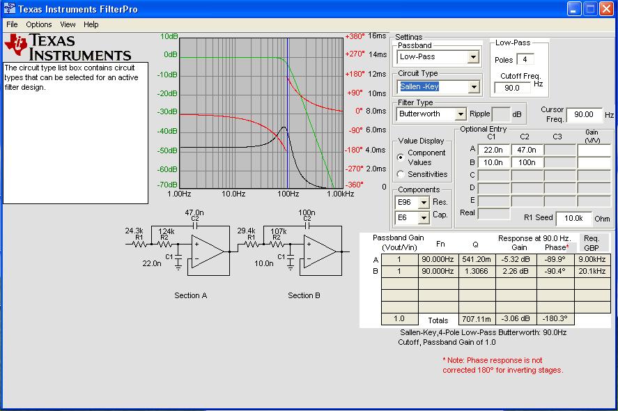

ok i made a filter and i does not work i was wondering if all capacitors work or do they have to be different kinds for audio also does the opamp matter i'm using a dual opa2132 does that work with audio? also please take a look at the circuit to see if it is ok. please reply asap.
The circuit topology looks ok. You are running the opamps on + and - split power supplies, right?
If not, you will have to bias the inputs so that they are approx. half-way between the positive supply and ground.

Thanks put i think that chip was bad so i replaced it with two lm336 and now it works put it is cutting 19db and i have to hit it with such a high level my mixer is distoring. also on that chip pin 4 is Ground but does that mean that you connect ground and -9v power to it? please help!
LM336 is a voltage reference diode????

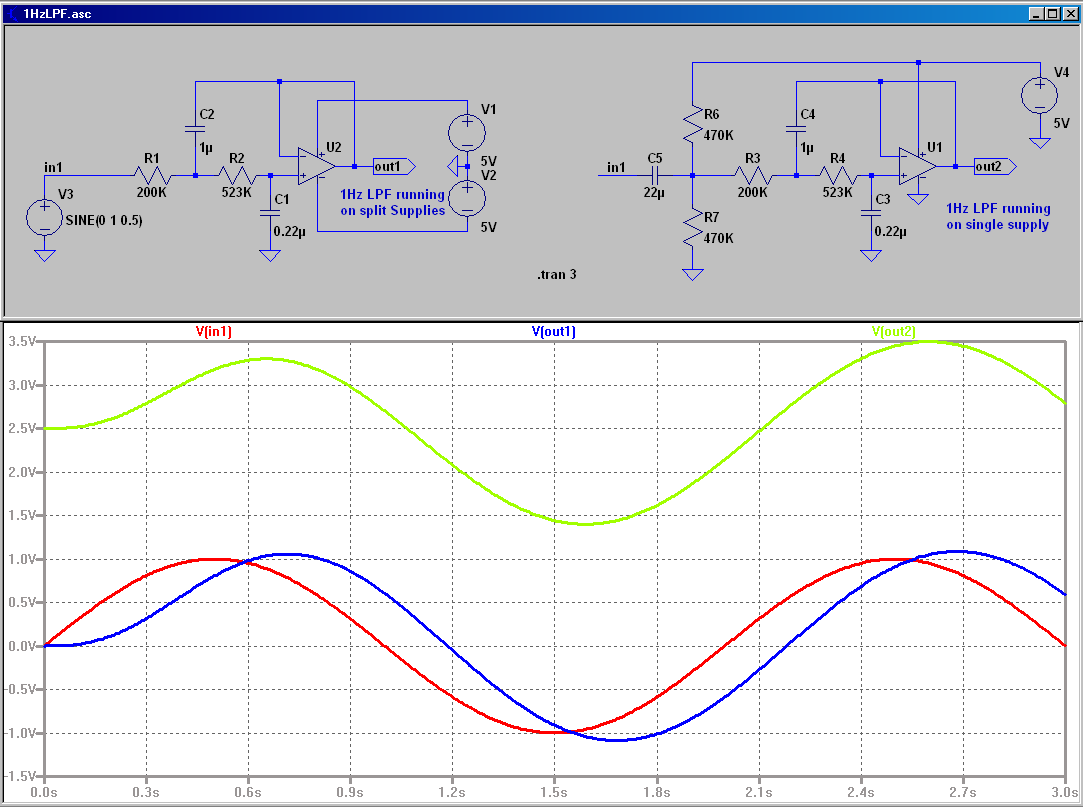

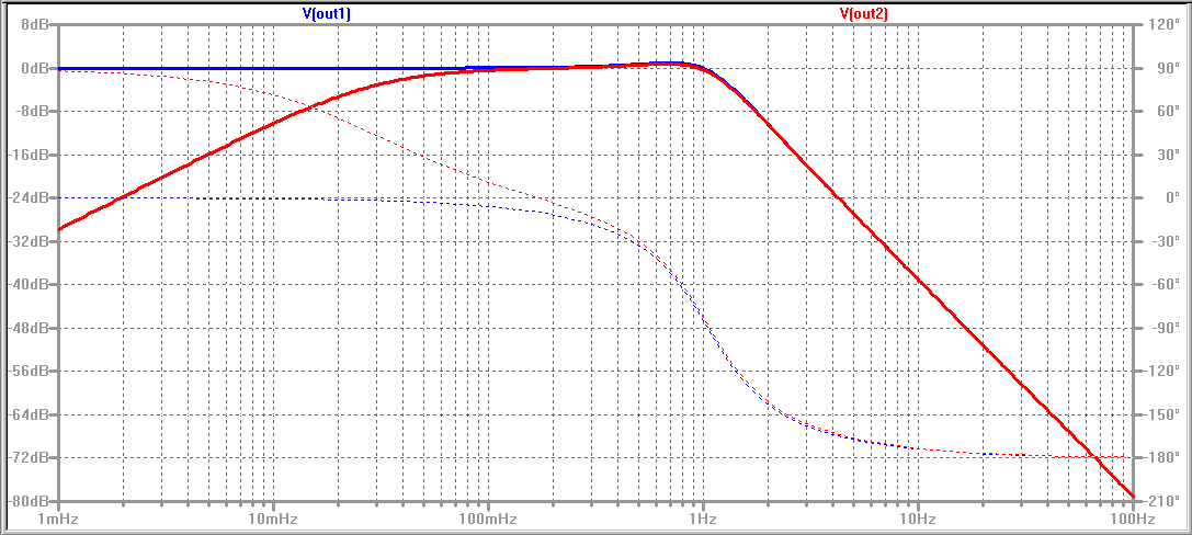

Here are two examples of LP filters; one that is running on split supplies, the other that is running on a single supply. Note that with split supplies, the input signal In1 can swing symmetrically around ground, and so does Out1. To run on a single supply, the input is biased half way between ground and Vdd by the two 470Ks. A coupling capacitor feeds the signal to the junction. The filter works the same, except its output Out2 is now centered at half Vdd.
Note that the input coupling capacitor adds turns the filter into a band pass. Look at the second set of plots which are a Bode plot of Out1 and Out 2.

An LM386 is not an opamp. It is a power amplifier complete circuit. It has built-in biasing and built-in negative feedback so it will not work in your opamp filter circuit.

Ok, thanks i replaced them with a opa2132 will that work? because i'm still having a gain problem but the filtter works if i give it lits of current but then my speaker distorts. could that be because i told the software to change the capacitors and now the resistors are too big?
ealso in the software it says you can change the capacitors but if you u enter one that is bigger then 1uf it says they are not supported but it puts some in that are 1u what is that? please help!!!
Ok, thanks i replaced them with a opa2132 will that work? because i'm still having a gain problem but the filter works if i give it lots of current but then my speaker distorts.
An OPA2132 is an opamp, not a power amp. It cannot drive a speaker.
Your opamps have no input bias voltage, no low impedance signal source and no power supply.
The filter circuit has a gain of 1 at very low frequencies.
I'm going thru a power amplifier but i got the whole circuit to work now thank you for your help.
