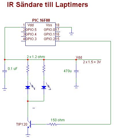

I have made a IR transmitter that is driven by 2 AA batteries (3V) look at the scematic.
But i have a problem, it is not reaching far enough!
A week ago i made a IR tranmitter with the same scematic but i used 6V instead and used larger resitors and had the led's seriell instead of parallell. That one had ways longer reach.
Why doesn't the 3V version work good?
The transitor i am using is a Darlington switch for currents up to 5A or something. But in my circuit there's just 1 to 1.5 A.
Any ideas what i should do to get it work better? Is the voltage drop in the transitor to big so that the voltage over the leds get to small? What can i do to get aroung this problem? I need to use 3V...

I've just done something similar using a 16LF628 (LF for the extended low voltage operation). I used a single LED, with a 1 ohm series resistor fed from a BC337 with a 330 ohm feeding the base - this worked fine.
I would suggest it's probably not a good idea to use a darlington, they often have a fairly high voltage drop from collector to emitter - try using just a normal transistor instead.
If you have a scope try measuring the voltage drop across the darlington!.
I have meassured the voltage drop with a scope. I meassured between ground and collector, is that right?
There is 0.8 to 1 volt. Is that much? How big is the voltage drop on your BC337 and how much current can it handle?

Have you measured the current trough the IR diodes? I think that the current is interesting.
You should compare the current to the 6Volts version.

I haven't scoped it, but a fully turned on silicon transistor only drops about 0.1V-0.2V across collector emitter - a darlington drops a great deal more, which you can't afford with a 3V supply.
The BC337 is rated at 1A maximum, but bear in mind it's been pulsed with a low repetition rate (just as the LED's are).

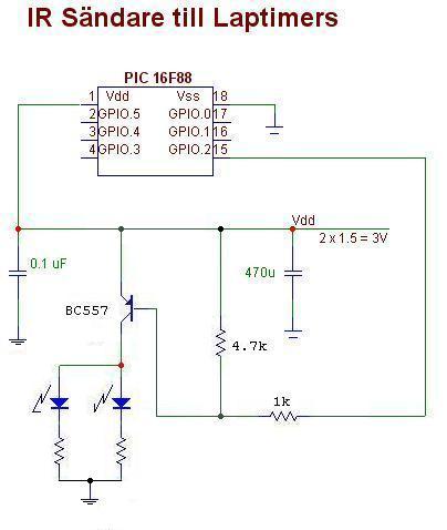

Use PNP transistor like BC557 to drive your LED. Most I/O pins don't source much current to hard drive any NPN transistor into saturation. Also if you want to drive NPN transitor to saturation, its base voltage needs to be larger than its collector voltage (both junctions should be forward biased) which is many a times not possible because in most cases collector is held at Vcc level and so you require another supply for supplying to base.
It is easy to sink current in an I/O pin. Thus you can easily drive an NPN transistor to saturation by making its base at ground (logic 0) potential while its emitter is connected to Vcc through IR LEDs.
See schematic below.

I disagree, with the LED's in the emitter of the transistor you are always losing at least 0.7V across the transistor - with the LED's in the collector it's reduced to 0.1V-0.2V.
Ok, I have changed the schematic now. Now LEDs should get max. possible power.

I have meassured the current through the LED which is just about 0.3 A (it is supposed to be 1A!).
I have meassured the voltage drops over the components.
U = 3V
Uled = 1.8 V
Ut = 0.8 V
Ur = 0.4 V
Would it be better if i changed the darlington to a normal transistor? Or can i change the resistor to a 0.4 ohm (0.4/1). Would that work good, not just theoretically?

The final PNP diagram was exactly the same as the original NPN one, but with less drive to the base (due to the 1K instead) - the only possible difference is the amount of current the PIC can source or sink - which for a 16F628 is exactly the same 25mA in either case. Personally I would use an NPN transistor, every remote control you ever see does!.
