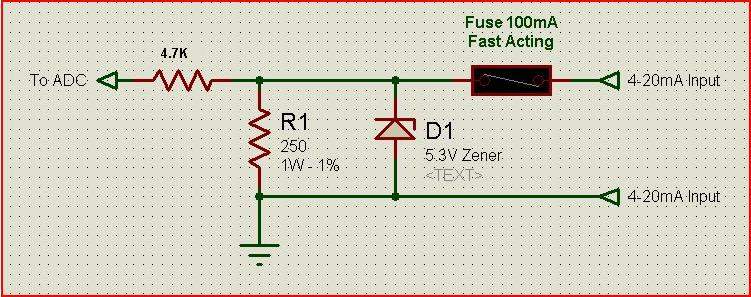

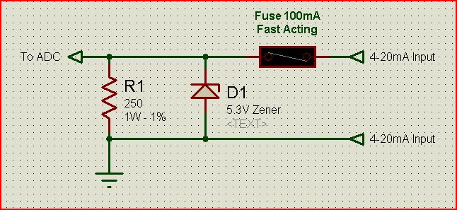

Setting up an input for a 4-20mA Circuit to a 5V ADC, Looking at the standard 250 ohm resistor to create the 5V signal at 20mA but I'm concerned with blowing the ADC if someone crosses the field wiring and sticks the excitation voltage (likely 24V) to the input.
I was fiddling with a zener / fuse setup (see attached) but the ADC lists 5.3v absolute max, and I can't come up with a combination of values that would work across the tolerance window. I ether get into the zener range too early or over voltage the input of the ADC.
How is this normally dealt with? (full isolation would be awesome!)

Mark R, why not simply use a clamp diode to VCC, and GND for that matter?
Sceadwian, in this application I do not think he is trying to protect the load from the source, but rather the source from the load.
Either way clamp diodes will work. He said he wanted to protect the ADC which is what is reading the voltage dropped by the resistor, I read that as trying to protect the load, as the source of the current is an external device.
I'm not quiet sure what you're protecting against though, you need to protect from reverse voltage of the sense resistor that's about it. If you can apply 24V directly to the ADC then that means your have an exposed circuit board or a bad connection layout. You can't protect a circuit from stupid people if it's all available like that.
You are correct that the ADC is what he is trying to protect. I misread. Usually fault sensing in 4-20 mA loops is for shorts.
And that is what usually happens. This is not a circuit board, in most cases it is hundreds of feet of cable in conduit, transmitting signals from a local transducer to a remote PLC or controller, and from that PLC to a control valve actuator. Sometimes short circuits occur, thus the limiting resistor.
I'm thinking that voltage clamping could cause problems in these kinds of circuits due to their nature.
How would it cause a problem? It won't even show up in the circuit until the voltage is a diode drop above or bellow the local VCC/GND connections.

I looked at the Maxim doc before, but it seems to be a solution for limiting the excitation voltage (source). This system will be installed by a third party, they will provide the power supply and / or transmitter
If we are talking about a powered transmitter, then that would be current limiting, no big danger, but a lot of 4-20 systems have a separate power supply with a passive transducer ==> https://www.electro-tech-online.com/custompdfs/2009/11/M3939.pdf If the run to the sensor shorts, the full voltage of the power supply would be present at the positive side of the sense resistor, no?
This is also the connection point of the adc pin, which can only take 5.3 volts before I breach the factory smoke containment system.
I re-did the math and I must have made an error before. With the resistor at the high end of the 1% tolerance, the transducer would have to exceed 5% over spec for the ADC pin to climb over 5.3V. I was getting 5.6-ish before. :rolleyes:

You could also use an OpAmp as the current to voltage converter and add two back to back diodes on the virtual ground input. The advantage of this technique is that there would be no voltage drop (very little: mVs) on the current sense input.
The ADC may already have clamp diodes to GND and VDD. If so, add a resistor in series with the ADC pin to limit the current for extra safety:

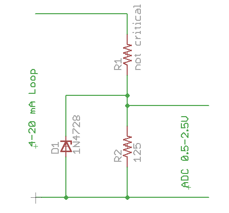

Here's something that's possibly a bit more practical. The ADC probably can be set for 0-2.5V range just by changing its reference. Or, maybe you don't need all the range. D1 is 3.3V which shouldn't affect accuracy, yet limits the ADC input to well below 5V.
