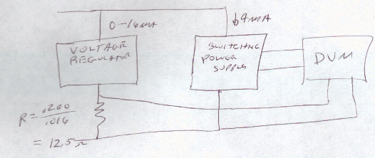

Here is one idea: The DC to DC converter uses 4mA. When the current increases, the voltage regulator uses the excess current. If you want to show 1.999 for full scale with a 200mV meter, the resistor is 12.5 ohms.
it's nice and simple idea but i'm not sure it is going to be good enough. 4mA consumption of the switching power supply is not precise and it can (and will) change during operation. it is better to measure total current and then compensate for 4mA offset. also does indicator have to be digital?
The load on the switching supply will be constant, so the input current will be constant. If it varies with temperature, you can compensate with a thermistor. You said you wanted a 7 segment display? that is digital. If you can use an analog meter, just change the meter scale, no electronics needed.
