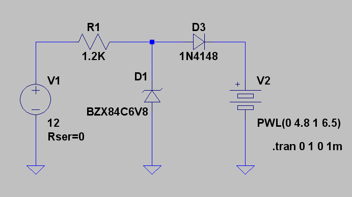

I just cannot figure out how to charge these
Ive tried a 5V regulator with the output limited to 60ma (resistor) and it diddnt charge it at all google spammed me with 4.8V batteries, so I am stuck here. Any schemmehs or tips?
specs:
4.8V
60ma
NICad
C/20 will work, but you might need a little more voltage.
Therefore if the batteries are 60ma then you can safely charge them at 60ma / 20 so 3ma won't hurt them.
Most of Cell chargers should work. Else, you have to create a constant current source. Simple way is to use a 7805 with a 2 diodes in the common path to ground. this will lift the supply to 6.4V approx. on the output put a diode for preventing reverse discharge and add a small resistor to limit the current to say 5mA.
you will find the battery charged in about 5 to 6 hours, as it was not charged earlier.discharge with an LED at say 25 mA until the voltage falls to just 4*0.8=3.2v and repeat the process.
The 4.8V battery needs a charging voltage of about 6V, not 4.8V.
It will overheat and POP if you charge it at 60mA. Charge it at 6mA and turn off the charger when it is fully charged.

Battery charger.
Hi Krumlink,
Try this one, I know it's a rather expensive and complicated
circuit but it's better than nothing. :D
on1aag.
That 4.8V battery needs at leat 6.4V to charge.
Just use a resistor, rectifier and mains tranformer - simple easy and cheap.
