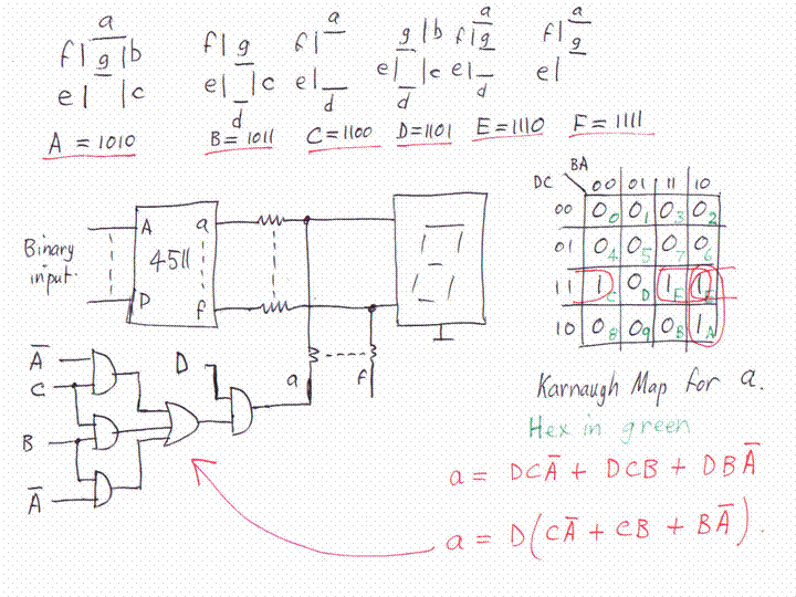

Be drawn and materialise in rasters a reasonable circuit that would appear in 7 seagments displays sectors the digits of hex system of numeration. the numbers that i want to see will be appearred as in the following form:
6 A B C D E F
Code the digits it will be given as BCD with Dip-switch
CAN HELP ME ΟR IS DIFFICULT?????
p.m. with multiplexter can i do it??????
i need something like this
i give the 1111 and i want to see the F etc
If I understand you correctly. It can be done with a microcontroller. You read the 4 pin dip switch and use a lookup table to get the value to write to the 7 segment display (and the DOT too if you need that.).
I looked at a few 7 segment decoders but none had the Hex outputs.
However, you could do it by using a 7 segment decoder (preferably one with open collector or open drain outputs) and do the A ~ F outputs with gates.
Also, it is not BCD, it is 4 digit binary. BCD implies 0 ~ 9.
Here is the gating for the "a" segment. You will need to draw Karnaugh maps for each of the remaining segments.
As you can see it will require a fair number og gates to do gating for all segments.
However, you may find some commonality that can reduce the overall number of gates.
It would be much simpler to use a PIC.
