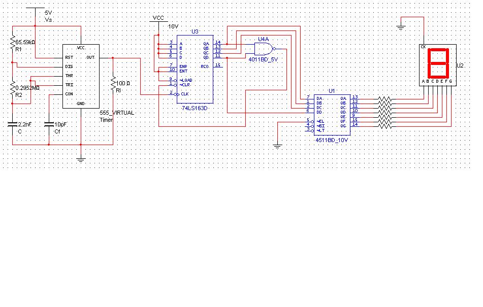

Hi Guys
Trying to get my head around this problem
Its a simple circuit really but funny enough its giving me some problems. I dont know if its the sim package or just me???
Using a 555 to generate a slow clock signal to drive a 4 bit synchronus counter. Connected this up to a 7 seg driver and 7 seg display.
When powered up all i get is a continuous lit up 7 seg.
Using a 74ls16 counter, 4511bd decoder, common cathode 7 seg, 555 timer.
can anyone see whats wrong??
oh and i have reset the count at 9 since thats all the 7seg can display.

I think you should make the LT and the BI inputs of the 4511 to Vcc.
On cmos IC's one should never leave input pins floating, they need to be tied high or low. The LT when is low all segments are turned on. Leaving it floating is probably the problem.
Also no need to have the resistor from the output of the 555 to ground.
The 10pF capacitor on the control should be changed to about 0.1uF.

Yep its working now, thanks alot.
Funny i didnt even notice them inputs without a connection

Two supply voltages without any logic level conversion?
With a 10V supply, the TTL counter might release some of its majic smoke.
With a proper 5V supply for the TTL counter then its logic high voltage won't be high enough for some Cmos 4011 and 4511 ICs.
Use a Cmos counter.

I'd just run the whole shootin' match on a 5v rail.
If that 2.2nF timing cap happens to be ceramic, timing resistors with that kind of precision will be pointless because of the cap's tempco.
