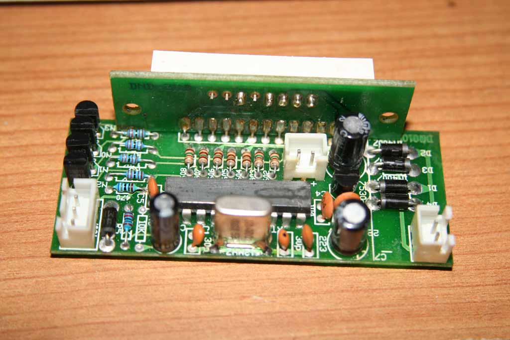

Drill press
Ok so I decided to pull the rpm read out out of my drill press. first off good news it's got a 9v powersupply but the transformer thats next to this board says it's 9vac which is depressing. but it plugs right into this board. this board has a power input and a laser output and emitter/collector connector. so if i'm correct it needs to have a ac to dc converter somewhere on the chip or could the transformer be read wrong. here is a list of every thing thats on the board. every thing is labled with a silk screen except for the ic which is sanded on the top i'm assuming to remove any of the identifying marks.

1 - 20 pin chip of unknown markings (pcb has XTAL next to it)
1 - power connector
1 - 1 emitter/detector connector
could someone look at the picture and make a guess as to what it might be?

The IC looks like a microcontroller of some kind. It may be a RYOBI special.
So you would have to buy a comercially available PIC and do your own programming.
Alternatively, do it with counter ICs.
ID, nearly everything electronic runs from DC -- radios, TVs, computers -- and AC is rectified to one or more DC supplies for the electronics. So never let what appears to be an AC supply trip you up.

Ok so i got to thinking ... D1, D2, D3, and D4 not act like a converter? like maybe a super basic one? looking at my diagram for a rectifyier it has 4 diodes in it almost similiar to the way this hooks up am i wrong thinking about this?
please reference picture in before post
D1 -D4 is on the right hand side next to the white power input connector
D1 - D4 look like a rectifier bridge. So these, in conjunction with an electroylitic smoothing capacitor, rectify the AC to DC.

Actually, you can learn a lot from that picture.
First off, the 4 bjts on the left drive the 4 digit display, therefore it must be multiplexed, as there is only 7 segment resistors. The xtal also is a key indication that this is a microcontroller. It may even be a PIC! The diodes on the right indicate that it accepts an AC source, with minimal filtering. There you go..
