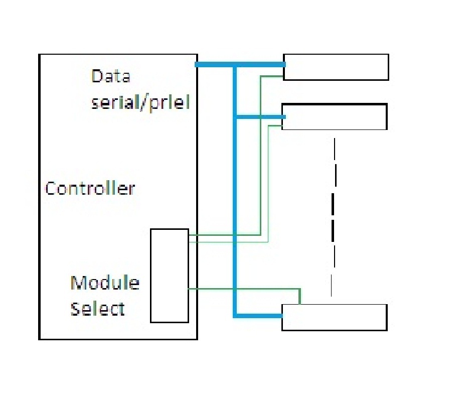

I m going to design a 4 digit 7 segment display module. I want to use about 10 to 15 such modules using 89V51RD2.
I want to implement it by multiplexing method making use of 4511. Each module could be selected individually and data is latched on them.
Here are some ideas i got...
1. Use a 4511 for each display. (4 no.s in each module)
2. Data to be written to BCD inputs using uC 8 bit port where display selection can be done by a decoding ic 138.
3. Or data can be written serially to a 16 bit serial in parallel out shift register IC on each module.
I just want to implement with minimal pin usage and wiring. Rest I can handle in code.
Check out the block diagram and please suggest the best solution. I hope there are many consistent members on this site who could have already done this.

rather than making direct single out put to select modules, you can work out to select 7 segments like this
to display a 7 segment you need 4 bits ( for 0-9)
15 modules totally have 15x4=60, 7 segments. you need 6 bit data from uC to give to address decoder to select addresses.
if i am correct you need minimum 11 out puts. may be the way you told also will tell the same.

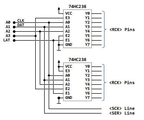

If I understand correctly, you're talking about using four (4) '4511 ICs in each module. Does the '4511 latch data? If not, then you might consider using four (4) daisy-chained 74HC595 ICs in each module instead of the '4511 ICs. You would connect all of the <SER> pins together and all of the <SCK> pins together on each module and drive these paralleled <SER> and <SCK> lines using two pins on the microcontroller. Connect the <RCK> (latch) pin on each module to a unique line on the microcontroller or multiplexer IC. When you update an individual display module you would send 32-bits of display data, which all the modules would receive in parallel, but you would only "latch" data onto the outputs on one of the modules by pulsing its <RCK> (latch) pin. Since the 74HC595 has an Output Enable pin, you could connect them all together in parallel and drive them with a PWM pin from the microcontroller for 'global' PWM brightness control. So you need two (2) pins for the combined <SER> and <SCK> buss lines, four (4) pins for a 1:16 decoder, and one (1) pin to pulse the decoder enable line to output the <RCK> latch pulse to the modules. Seven (7) pins, or eight (8) pins if you decide to use PWM brightness control.

After thinking about it, I think you can use 5 pins instead of 7 pins since you only need to address the decoder ICs when you send the <RCK> latch pulse. That means you could use two of those address lines as <SER> and <SCK> lines to load all of the 74HC595 shift registers and then set the decoder A0..A3 address lines and then send the <RCK> pulse through the decoders to latch data onto the ouputs for the selected module. You can also use those A0..A3 lines to drive a switch matrix when not updating one of the display modules.
Regards, Mike

1. I have to use Serial data to be driven by RXD TXD lines (Mode 0)?
Not sure on your particular mcu. I usually bit bang the clock and data signals. Assuming 16 modules, I would use a display array with 64 elements, each element containing 0..9 values, and the driver would use values from that array. Perhaps something like this;

    portb = module;                  // set RB3:RB0 (decoder A3:A0), 0..15
    lat = 0; lat = 1;                // latch selected module only
