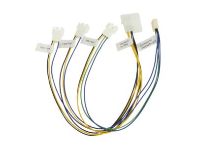

And another option: If you have modern fans that are PWM'ed to speed up/ slow them down, you can use this:
Newegg.ca - Rosewill 12" PWM Splitter Model RCW-FPS-401
It takes the power of the PSU, and the PWM signal from the mobo to vary all of your fans.

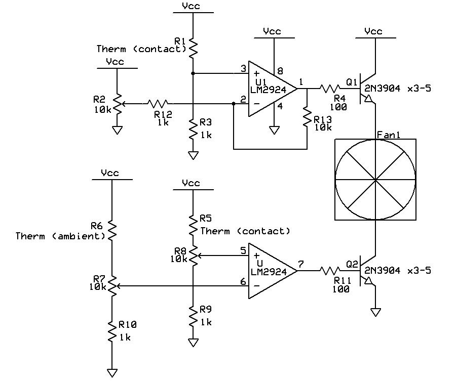

If you are looking at the possibility of making your own fan controller, then I would recommend using something like my fan controller. I have several versions of the controller and each does something different in terms of cooling.
Are you looking for a PWM controller or is a different type of controller acceptable?
Here is the schematic for one version of my fan controllers.

I need manual controller not temprature controlled
If you just want straight up manual control then just use simple pots to control the fan(s) speed(s). I provided some pot values to work with and suggested you place them in an open bay.
