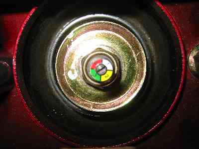

Wow, thanks all for the quick responses! I really appreciate your help. :D Here's some more detail to the project.
I'm a bit of car buff and I have adjustable shocks/struts on my ride. To adjust the shocks, you take a tiny screwdriver and turn a dial on the top of the shock tower. To be more specific, you have to push the dial in about 1/4" and then turn, so the motors will have to be set on small solenoids. I think it would be super trick to be able to adjust them from inside the car. So that should answer the question of how far apart the little motors are, and no, the motors don't move. Also, that's why I only need 1 dial for 2 motors, since the front-right and front-left shocks will always be set to the same firmness settings. (I will run identical setups for the front and rear, but I wanted to simplify the question, so I'm actually going to use 2 dials to run 4 motors).
As for my reference to the "printer input selector"... well I hesitated about using that since they don't really use them anymore, but this is what I had in mind (except with 4 possible settings). Obviously, since this will be somewhere in my car (probably the glove box) I'll want it to be smaller.
I'll post a couple pictures of the shock tower adjustment in a few minutes...
The small black section (with the slot) in the center is what I'm trying to turn. You are free to turn it either way (i.e. you are not confined to clockwise or counter-clockwise movement.
Another option that might be simpler is to just have one button for each motor. Each time you push the button, it rotates the motor 90degrees. Would that simplify things?
how would you make the mechanism for
pressing the end down,
and turning the stub ?
And letting the end back up again i suppose.
The circuit would come afterwards,
in many ways the circuit is the easy part.
Regards, John :)
Is there such a thing as a combination stepper motor and linear solenoid? If so, then all we need is a circuit that, when a button is pushed, extends the shaft, rotates 90°, then retreats. Is that possible?
Well nothing ready-made comes to mind,
i think such a unit would have to be specially made.
**broken link removed** lists something called a "Combination Linear/Rotation Drive Assembly..." but it looks like it won't work. There must be something like this available with an external shaft...
Can you get in contact with the manufacturer of the damper mechanism?
It would make your task simpler if the need to push the screw before turning could be removed.
