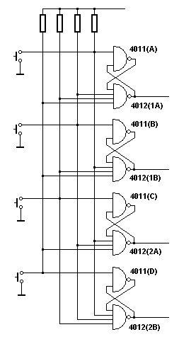

Hi.
Recently I would like to do a circuit witch have 4 push buttons and select 4 independent outputs.
True table
S1 S2 S3 S4 O1 O2 O3 O4
1 0 0 0 1 0 0 0
0 1 0 0 0 1 0 0
0 0 1 0 0 0 1 0
0 0 0 1 0 0 0 1
How I can get this circuit?
Somebody can help me? Thanks.
Toni. :(
Do you want only one output to be active? In other words, if I4 is true, and I push S2, should I4 go off and I2 go on? I'm assuming this is what you want. Otherwise, you would need a reset button.
The good old SAS560 IC (for TV channel select) do this exactly...
Or You can build some similar..

I think the title of the post has the answer - "with memory". My guess is that the pushbuttons are momentary (as most are).
