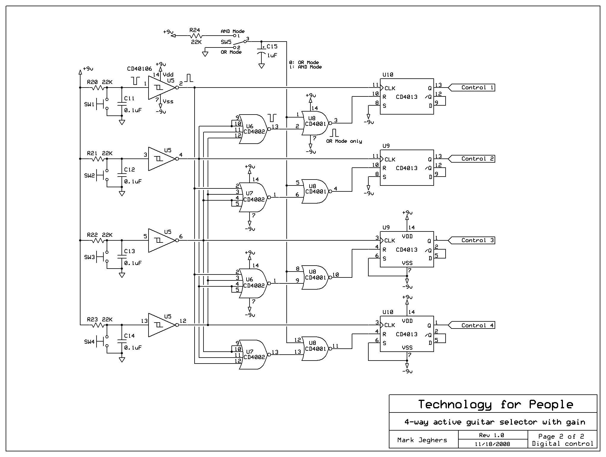

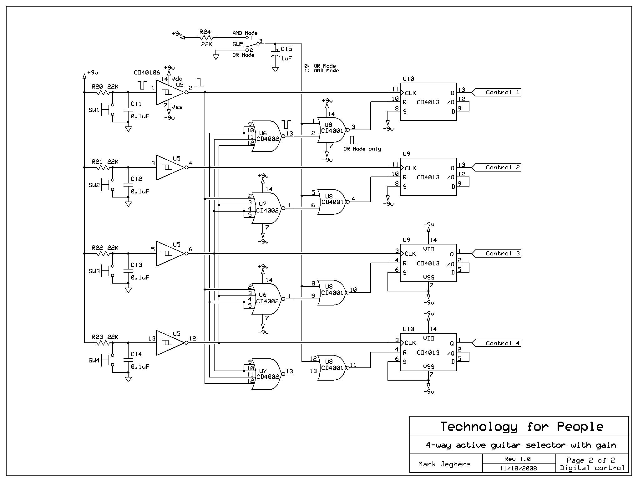

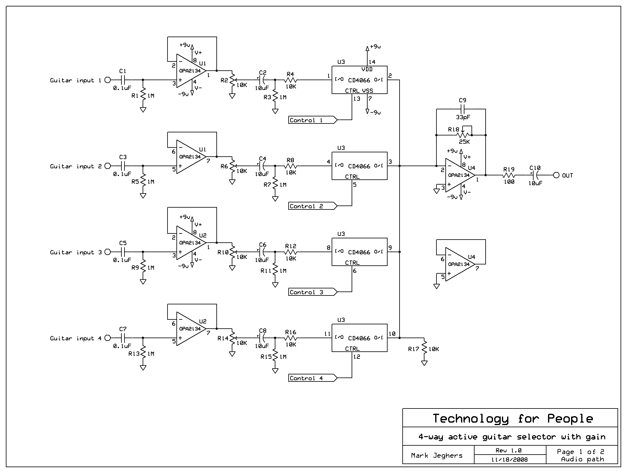

All,
Here is my first draft for the design of my 4-Guitar Selector Switch with Gain. I am using OPA2134 op-amps for the audio buffering and CD4066 analog switches for the guitar selections. I am considering using a better analog switch to reduce THD. The design goals are described at the end of this posting.
I would be most grateful for any review/comments/suggestions you all might have. If there is a way I can improve signal purity, simplify, conserve power, whatever, I'd love to know anything I've overlooked.
Also, there are specific questions I am wondering about - if anybody has answers to these questions I'd be most grateful again.
Here are links to download my schematics, both in BMP and JPG format. JPGs are a little over 200k, BMPs are close to 400k. The schematic is in two parts: the audio path and the digital control...
Audio Path:
https://www.t4p.com/ftp/pub/3-Way Guitar Selector with Gain - Audio path.bmp
https://www.t4p.com/ftp/pub/3-Way Guitar Selector with Gain - Audio path.jpg
Digital Control
https://www.t4p.com/ftp/pub/3-Way Guitar Selector with Gain - Digital control.bmp
https://www.t4p.com/ftp/pub/3-Way Guitar Selector with Gain - Digital control.jpg
Here are questions I am hoping someone can help me with:
- Are my electrolytic cap polaities reasonable?
- I hear CD4066 switches still introduce some THD (enuf to negate the benefit of nicer op-amps), any other analog switches that might do better?
- Any better place in the audio path to place the analog switches? Any better way to turn the guitars on/off instead of CD4066s?
- Unity gain buffers offer hi-impedance inputs for the guitars, final op-amp mixer provides gain. Reasonable?
- Is the biasing of the op-amp inputs ok?
- Any decoupling caps that could be dispensed with? Any more needed? Are the values reasonable?
- I plan bypass caps between both power rails and ground, what values would be good?
- I plan to support both battery and extrnal power, would that affect what the bypass cap values should be?
- Would it be worthwhile to try using a single 9v power source, not bipolar (+9v/gnd/-9v)? I'd have to introduce a Vref with a power-draining resistor network, which I don't like.
- How much gain could I count on getting before the signal clips using just +9 and gnd? How much gain using bipolar (+9v/gnd/-9v)?
- Any ideas to reduce noise? To keep op-amps stable? To reduce power consumption?
- Any obvious flaws in the digital control? In OR mode, only one guitar at a time can ever be selected, in AND mode, any combination of guitars can be toggled on/off.

I can understand the need for a switch box for a variety of guitars, was curious as to why you needed it.
Have not played for years but still have my VOX AC 30 T/B (1967 ish) and my old Ibanez Musician close to a SG lookalike.
I can't help you electronically but have a look at the attached GIF's perhaps they will help.
The first circuit would require that have all your guitar volumes set to zero. When ready pick up the guitar dial to 100%, when finished dial the volume back to zero and repeat. What I would do with this circuit is to fit a bypass switch across the gain resistor, add a variable resistor of suitable value so that you can preset the gain to want to create a volume pedal for lead breaks.
The second GIF has three circuits for your perusal.
