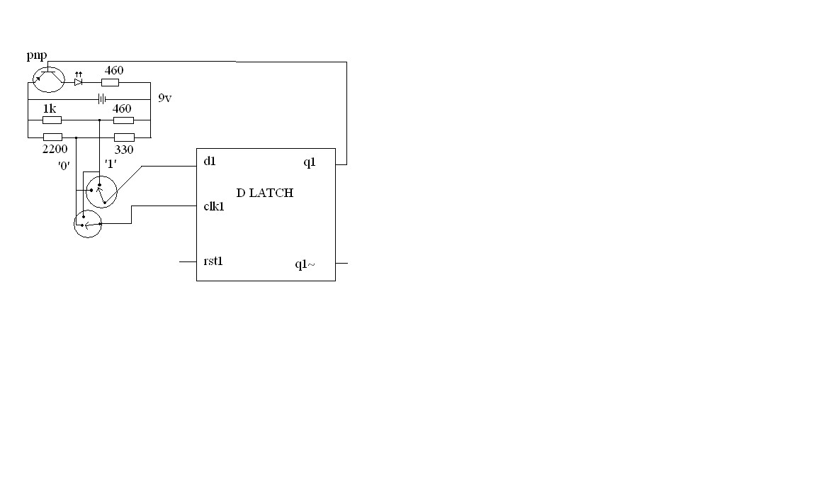

i created my own test circuit for 4013 ic.
what i have done is use of voltage devider circuit. it devides 9v battery to 3.5v and 1.5 v which are required Vih logic'1' & Vil logic'0'.
for output i have connected pnp transistor because Ioh= -1.36ma. so connected to base which will drive led. i left open other pins.
i have not tested this circuit yet but i want u guys to tell me if this circuit will work or not.
Are your values absolute max/min ratings? ( I'm too lazy to look them up ) A simple switch will not work for the clock input. At a minimum, you need a "debounce" circuit. Your indicator circuit will light when your DUT is in reset. Q=LOW. Also, your divide resistors don't produce the voltage you want.
they are absolute maximum ratings.
"Your indicator circuit will light when your DUT is in reset. Q=LOW." why is that. should i connect npn transistor up there.
and whats wrong with voltage devider circuit is that the value of resistor ?
circuit does not work

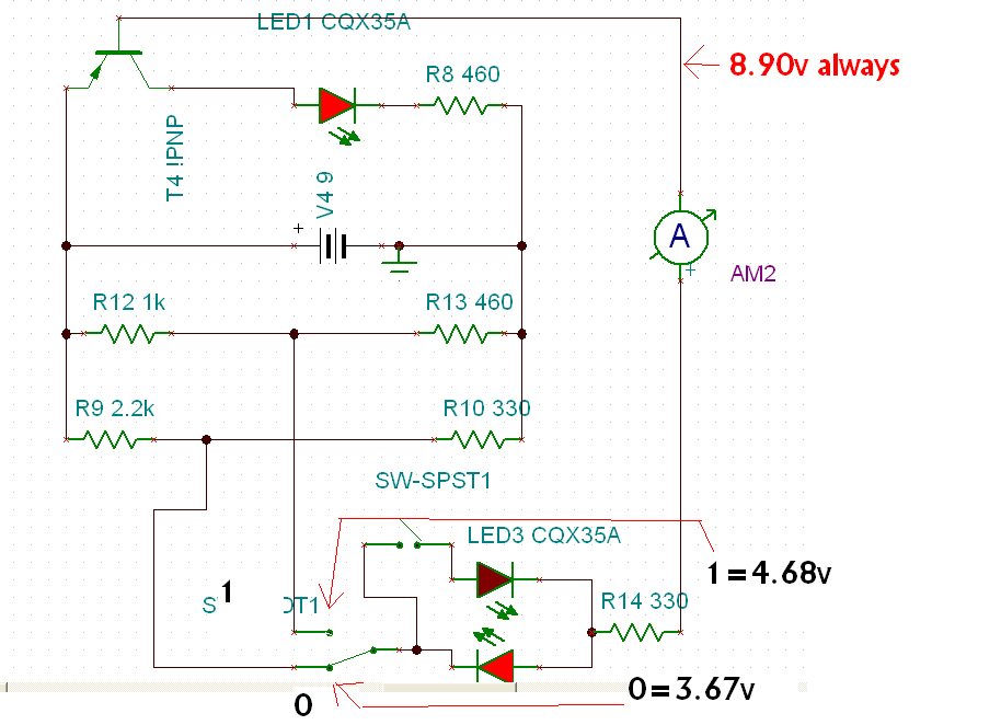

just for fun I put your circuit into Tina
attached are results.
you never achieve a LOW for data input
your switch won't clock properly as it will bounce
just use a 555 clocking very slow to see how the 4013 works
attach LEDs to the outputs and data in to see what states the pins are

Your 4013 is not powered so it won't work.
Its output current depends on its supply voltage.
Its input voltages of +3.5V high and +1.5V low are only when its supply voltage is +5.0V, not when it is +9V.
Your +3.5V and +1.5V settings will be reduced as your 9V battery runs down and should be powered from a regulated voltage. A low dropout 5V regulator should be used.

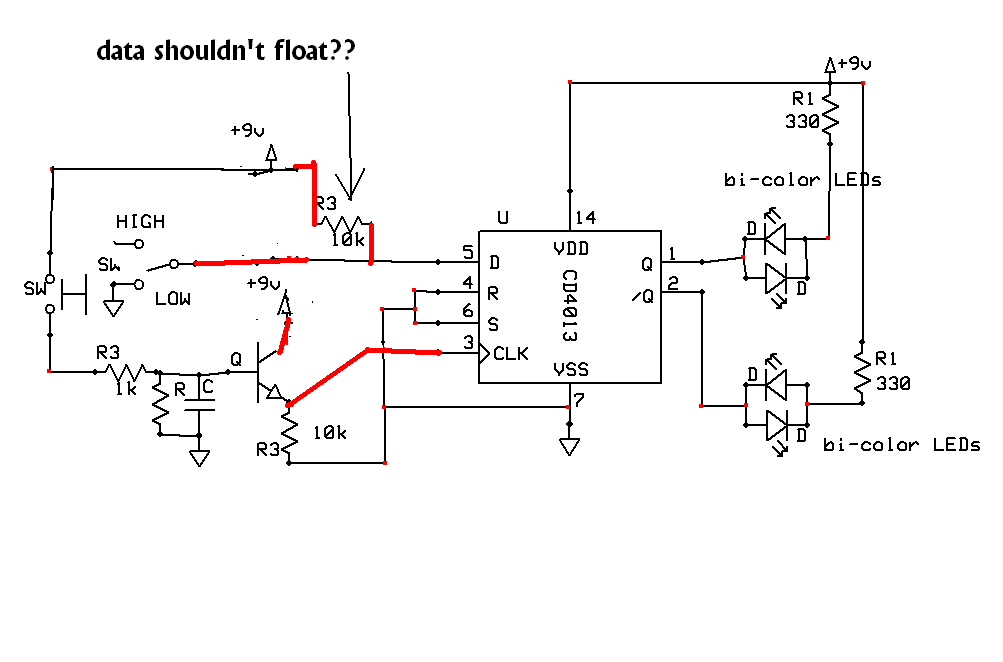

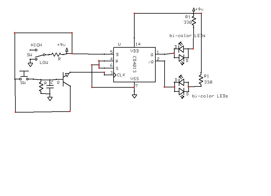

here is a test circuit
for the 4013
plain n simple
should work??
I think your transistor need some kind of bias on the Emitter. I wouldn't trust the circuit as shown.
Laurier also got it wrong.
You must never let a Cmos input float. It needs a resistor to ground for it to be low.
Your High-Low switch does nothing because your D input is connected to +9V.
only got half wrong??
the high low switch is correct I am pretty sure
the 9v is connected to D input for high
when switched to low the resistor R3 is grounded.
I might should have R3 connected to 9v then ground w/ switch??

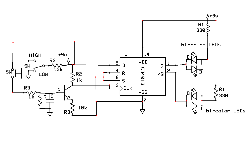

revised schematic. Probably have too many resistors connected to transistor.
attempt to keep current low I guess??
started inputting into Tina to experiment w/ different configurations.
not right I am pretty sure but ??

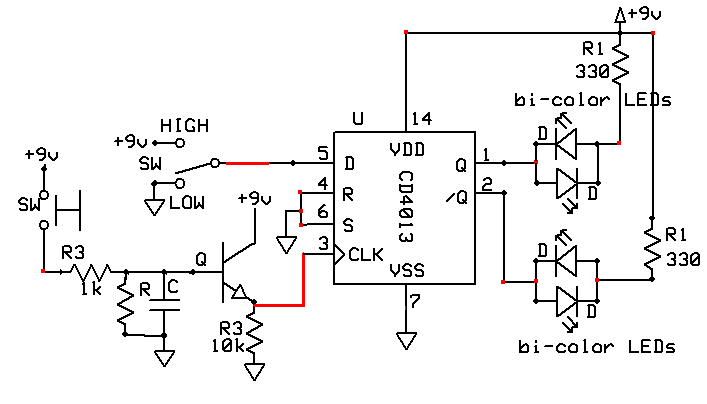

Naw, the hi/lo switch won't work. The D input should be connected between the resistor and switch. Look at how you have the clock connected to R2. That's how it should be done ( think of the transistor as analogous to the switch ).
And R3 is going to prevent the clk signal from getting to a reasonable low. By R3, I mean the 10K on in the emitter, not the 1K one in the base circuit.
It is simple to wire the switch to be high-low and to wire the transistor to pull-up and the resistor to pull-down the CLK pin.
if i use +5v as a souce. and if i use flip flop multivibrator as a input to clock. will my circuit work ?
i have understood all of the thing above.
but how u people are using clock circuit. whats the role of capacitor connected to base of transistor ?
That would be ideal. A 555 circuit will work. Since the 4013 is a CMOS device, 9V is okay.
The resistor and capacitor together make what is known as a RC timing circuit. During the time it takes for the cap to charge, the mechanical vibrations of a switch are ignored, resulting in a clean signal to the base of the transistor.
