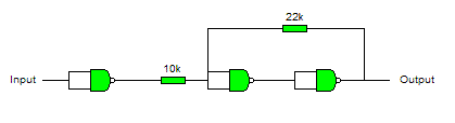

I'm having trouble with a 4017 IC. I have it wired up as follows:

The issue I'm having is that it transitions as 2 pulses when i trigger the relay. If I trigger the relay within a very short time frame after it is released it will pulse as 1 cycle, advancing by 1 led. If I wait more than roughly 1-2 seconds it will advance by 2. Any ideas on the issue?

hi danuke,
A better choice of for the ic would be a 4093 quad dual input NAND schmitt. They are pin compatable with 4011.
The RC filter has a slow risetime, so the output of the 4011 will oscillate as the risetime voltage passes
thru the 4011 input transition/switching value.
The 4093 has a schmitt input which will prevent this oscillation.
Post a diagram of the circuit.
Check the maximum output current from a 4017's output pin?
I take it you're not using the other gates for anything.
You can build a schmitt inverter with three NANDs.
