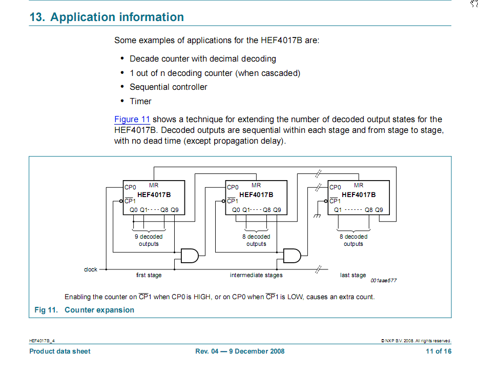

hi i want to use two 4017 in cascade such that first 4017 ic count up to ten then second 4017 ic will be enabled and first one would be disabled when second 4017 ic complete its count then first 4017 ic will be eabled again and so on
can any one help

Is this what you mean.?:)

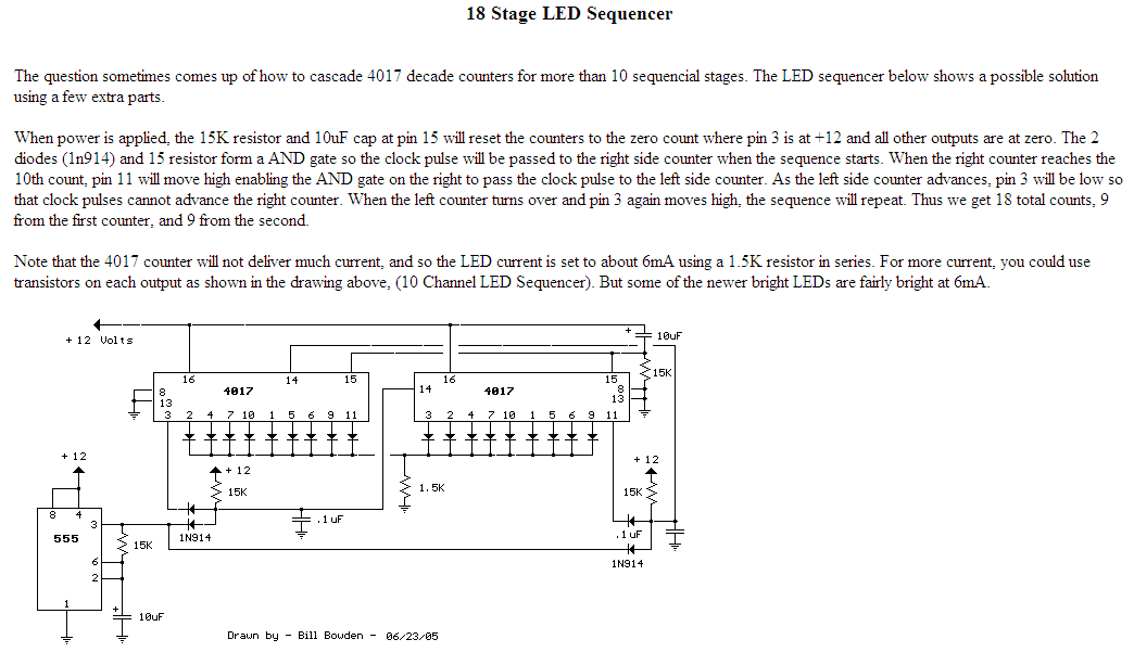

Bill Bowden uses "Mickey Mouse" AND gates made from diodes:
... but you can cascade as many of them as you want to get the desired number of outputs ...
