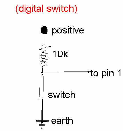

Is it really that simple? My understanding is that, as long as your PTM switch (PTM=push to make? Same as NO=normally open?) is depressed, the LED is off. You need 3 identical circuits like this, and they have no interaction with each other?
I think the chip you are using, uses digital inputs.
if this is true then:
Connect a 10k resistor from Positive to pin 1.
Connect your switch to pin 1 and Earth.
Let me know what happens.
ps.
positive supply to chip=pin 14
earth on chip =pin 7
