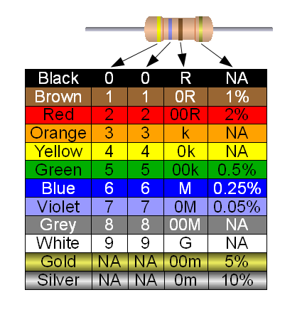

Hey all I am in need of some help. I have a Resistor that i need a replacement for. According to the Resistor value chart i have it is a 41 ohm 5% tolerance (Yellow - Brown - Black - GOLD). I can not find one. One thing i am not sure about is the wattage i think it is 2 watts as it is the same measurements as some 2 watt resistors i have. If anyone knows where i can find some or how i could get this value please help.

The value is 5% tolerance which means it can range from 38.95Ω to 43.05Ω so if you're certain it's 41R, just replace it with the nearest E24 value, 43R or 39R and it should be fine.

now here is the part i dont understand when i test the burnt resistor it test aat 8.2 +/- ohms however the color code calculators colors in no way are close to the colors on the resistor (Gray - Red - Gold - GOLD)
Yes, grey, red, gold, gold is the correct colour code for 82R.
The colours often change when the resistor is overheated, although I wouldn't normally expect grey to change to yellow, stranger things have happened.
