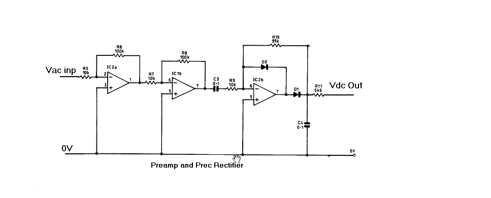

You need two parts to the circuit, first an amplifier (which you already have a poor confusing example of), follow that with a precision rectifier circuit.
As you're amplifying AC only you need an AC amplifier not the DC one you've shown, check the sticky at the top of one of the forums for correct examples of how to connect an opamp amplifier.
I would suggest an MC33202 opamp for that one. Output swings rail-to-rail, input near ground sensing, and you can drive it off a single +5v supply after you find Audioguru's schematic.

The type circuit you require will be a version/adaptation of this image.

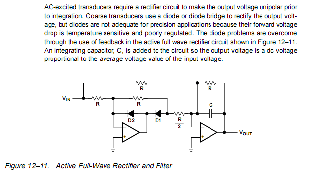

Could someone point me in the right direction for designing a precision full-wave rectifier and how to choose the capacitor values for it?
edit: I gave this a shot and am using 10k for R, what should I use for the cap?
That was the plan, however if the signal is changing fast then it might be too difficult to do reliably, I'd really like to test out both designs though, see what gives us better accuracy.

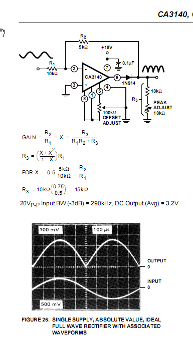

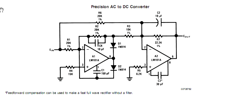

I dont see a R or C which components are you referring too.?
Sorry the image didnt upload properly, here it is now.
This pic is what I based it on.
Look at these two images for ideas and component values.

Thanks for that ericgibbs you have been very helpful, I will have a play over the next few days and report back if I have any issues.
