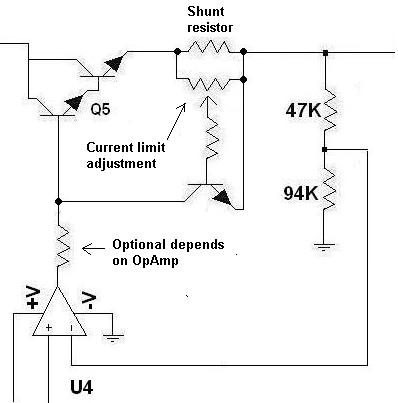

As mentioned by AG, your power supply is much too complex for an AF amp.
Also, simple current limiting (Constant current) is usually done in a much simpler way using the pass transistors to waste the power rather than a second set of devices:
ilimit-jpg.30328
Thank you very much!
I will try my best to test this tomorrow in the lab. I like the simplicity of pass transistor to limit the current. However, MOSFETS can be cascaded many times for more power. It is not simple to cool one transistor that will have a lot of power dissipation across it when the supply is shorted and limited at 4Amps. My goal will be either 4 or 5 Amps (depending on how much the Transformer is going to heat up). Further, MOSFETS don't have the thermal runaway problems.
I will test both setup for current limiting. Thanks again for your suggestion, time and interest.

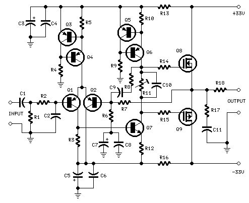

Frosty_47 said:
I imagine that some of the ripple from the unregulated PSU will be passed on to the speakers.
If you look at a common design found on the net you'll see why a little supply ripple won't be a problem. C3 & C4 combined with R13 filter the +33V supply ripple out. C5 & C6 combined with R16 filter the -33V supply ripple out. The ripple doesn't get through Q8 or Q9 because the source voltages follow the gate voltages which are supplied from the extra filtered part of the circuit:
amplifier4-1-gif.30329
The amplifier above has the same issue as your design in that it won't output full power due to the extra Vgs voltage required. But it is a simple example and that is why I posted it.
Well the extra Vgs is not a problem to supply. This however, tends to increase the idle current by a lot. I am yet to design a circuit that will keep the Vgs at just the right level. However, this will probably vary from MOSFET 2 MOSFET, so an individual "tuning adjustment" will be required.

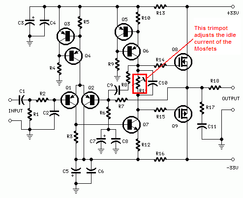

Can you recommend a simple method for keeping the idle current down in the push-pull MOSFET amplifier ? At +/- 30V the idle current seems to sit around 1Amp for me. I can't imagine what it will be at +/- 45V...
I'm not talking about the bias Vgs which sets the idle current. What I'm talking about is the fact that the audio signal output will not swing anywhere near ±33V because the source voltage is always apx 6-10V lower than the gate voltage (Nfet example). Now, if you powered your driving OpAmp from ±43V and the FET drains from ±33V, you'd be able to get close to ±33Vpk audio at full volume instead of ±23-27Vpk. To do this you'd need a separate low current ±43V supply for the OpAmps in addition to the high current ±33V supply for the MOSFETs. (Or you could stack two small 10V supplies on each of the ±33V rails)
Well thats exactly the method I used in my PSU design. Except for the voltages of course. Thanks for clearing this up, I will do just that. I got some OPA-454 Op-amps that can be safely operated with +/- 50V supply. And they are very good quality op-amps, perfect for audio amplifiers. However, I am still confused on how I should limit idle current...

I understand that negative feedback at the output will greatly attenuate PSU noise. But if the op-amps themselves are powered from a noisy PSU than wouldn't some of the noise still be passed on ? Although I suppose that this will vary from op-amp to op-amp. Don't most modern op-amps have good power supply rejection ratio.
I just checked out PSRR for OPA-452 and it's 40dB(min) at 10Khz, and 80dB at 90Hz. But that's not all!
OPA-454 has 70dB+ PSRR at 100KHZ! Holy SMOKES! That is better than LM317; typically 65dB (without Cadj).
You asked about how to adjust the idle current of the Mosfets:
