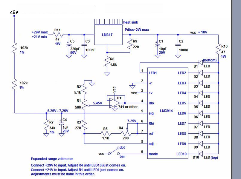

Hello . can some one help me build a 48V Battery Monitor . I have a bank of 4 battery`s 12V 200 AMp Conected to a solar Pannel and another saparate bank of 8 Batteryes 6V540A Conected to a 5KW wind turbine .
I would like to increase the battery spam life and keep them with discharge under 10%. So i would need a discharge monitor .
I found some schematics for 12V and 24V but i dont know how to modiffy them. Could some one help PLS :D

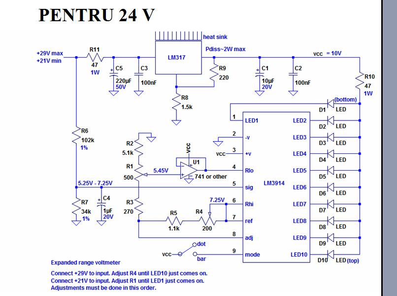

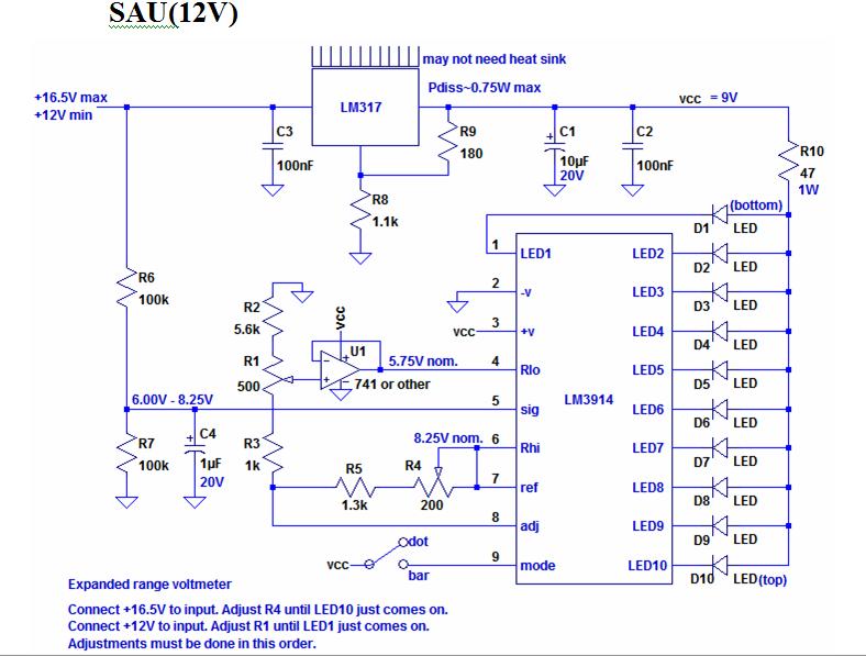

Post the circuit for 24v and we can work out the resistances for 48v
Here are the 2 12V and 24 V i found on the forum . The 24V i already build it for fun and it worked very good .
Also i had a 24V shunt regulator and when a friend of mine helped me modifiy it we also recalculate the resistive part of the entry curent.

You will have to have 2 inputs. Put 24v on the input of the resulator, exactly as per the 24v circuit diagram.
Get another 102k resistor and connect it in series with the 102k resistor on the circuit to make 204k and put the new 102k resistor on 48v.
In other words, remove the top of the 102k on the 24v circuit and connect it to the bottom of the new 102k resistor and put the top of the new 102k resistor on the 48v terminal of the battery.

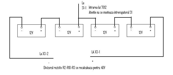

Do you have a source of 24V to power the circuits?
Yes .. I can wire it from the batteryes . Like this .. Also i have separate power for charging regulator, so from the right side il power the Monitor and from the left side il power the regulator.
