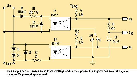

If I have a 0.7V AC between pins 1 and 2 on 4N35 optocoupler does I have a 5V output pin 5?
What´s the best way using an optocoupler to detect a corrent zero crossing?
If I have diodes supporting 5A and put two diodes foward and reverse biased between pins 1 and 2 of 4N35 does it work?
Forward voltage for the LED in the opto coupler is 1.2 volts, so no it wont work with 0.7 volt diodes. If you want to detect current zero crossings, use a current transformer. Put a reverse diode across the input to protect the LED.

I don´t want to use a corrent transformer, I don´t have space in my board and it isn´t economical...
In the attachment we can see that it´s possible just using diodes to detect zero voltage and zero current crossing!
The diference it´s that I have a much higher current, the maximum is about 10A, so I have to use power diodes (BY359 support 10A) to the current. The zero voltage crossing works with 0.7V diodes (1N4007). The diodes BY359, using in the corrent, has a 1.1 dropping voltage but I reduce to 0.7V.
Do you think I´m wrong or what I have to do?
Help me... I´m a little confused.

So the ideia is having a voltage drop between pins 1 and 2 more than 1.3V, that´s the led voltage!? That´s righ?
