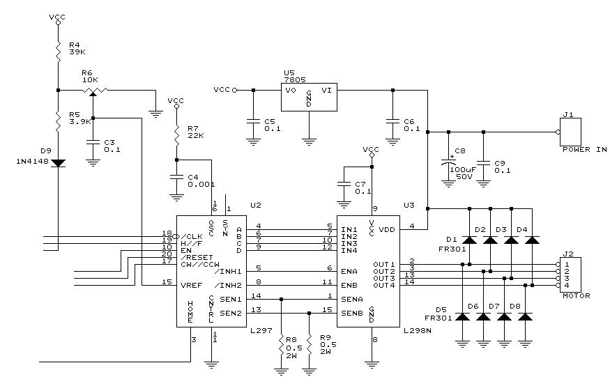

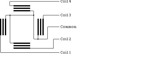

I am new to stepper motor. I do have a 5 wire stepper motor. shown in figure.
I wanted to build driver. So I found L297-L298 combination for driving my 5 wire stepper motor. I have found attached circuit to drive and I made it. But, I found that the circuit is used for 4 wire bipolar motor. As I am new, I want to know that how I can use this circuit to drive 5 wire stepper motor.
I think 5 wire is most probably 4 phase unipolar motor!!!
I have used controller to control clock( ton=20ms and toff=2ms) , clockwise and anticlockwise direction,reset and enable.
The Control pin is kept to ground.
Currently my motor does not rotate at all(not even any jerk.)
Is there something wrong???please advise...

Finally I got the solution.....my unipolar motor worked with l297-l298 configuration....

Seeing as the L298 has a rather odd footprint it would be wise to design a PCB. If you are going to design a PCB for a uni-polar stepper driver you may as well use an IC designed this millennia like the SLA7062 or just buy a module like the StepStick (the latter being recommended).
Modern ICs can do microstepping, internal sequencing (no need to do software control or use an L297) and have internal fet's with a very low Rds on making them much more efficient.

Driving steppers in a bipolar mode you drive the two coils (end to end) with H bridges (which the driving IC's have for you) and ignore the centre tap(s). I would not waste your time with L297 and L298 though (expensive, poor efficiency, large, crude driving methods), StepStick is a cheap widely available bipolar driver with microstepping (driving bipolar will give you more torque, as uni polar only energises half the coil at a time) and is very cheap at about £10 - you will not even get the L297 and L298 for that.
