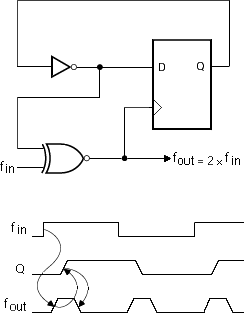

I am using the attached circuit to double my VARIABLE frequency,which produces a nonsymmetric pulse based on a not gate's delay.
Because I am feeding some and gates through latches and these are me latches enables,I need it to be perfect 50%,without change in frequency.
I am doing this in Xilinix Foundation's software's schematic editor which provides me with just simple logic gates.(no cap or IC)
Actually I am trying to make LS7084 IC through FPGAs.

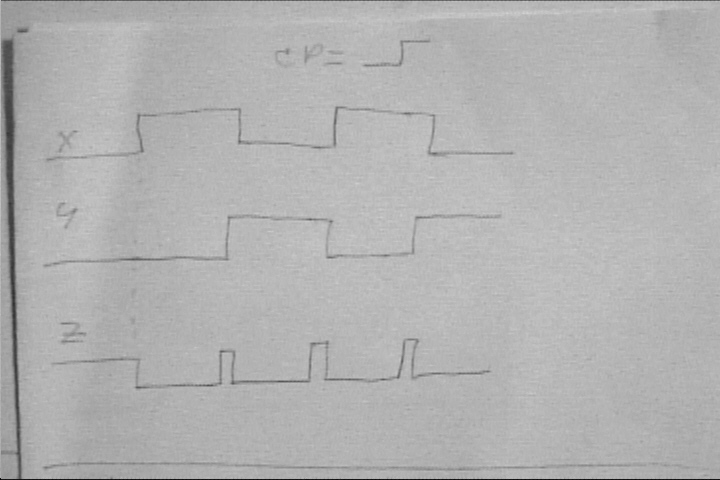

is this your output?

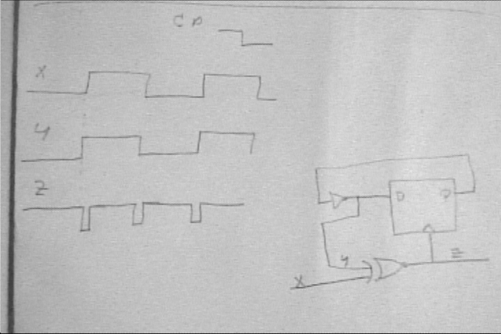

Z is the output with a positive edge clock input , with a negetive edge clock invert y and Z.
if you use a one shot you should be able to stretch the output to whatever you want plus you can use a positive or negetive edge to trigger it..
also what i have as Y input will follow F(in) with a negetive edge Clock input
with a positive edge Clock input Y is the oposite of F(in).
the width of Z or F(out) is the propagation delay of the exclusive Nor gate.as you said .
there has to be a better way.. anyway this is the other one

Yes,we can use two monostables (a positive triggered and a negative triggered) and then add their outputs to get it symmetric.
But as i said before I don't know how can I Make a monostable with basig logic gates I have in simulation editor.
But as I said before I don't know how can I Make a monostable with basic logic gates I have in simulation editor.
