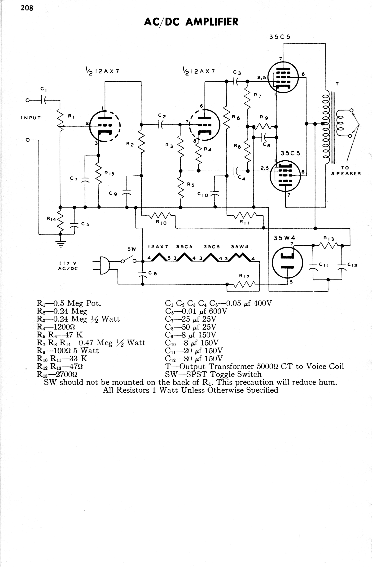

Does anyone remember the old 3 tube amplifier circuit that used a 50C5, 35W4 and ???? what was the other tube...........12AT6 or something like that?
Does anyone have this circuit?
I already did a web search there are 100s of old tube circuits but not this one. It was never a great amp but it was a fun project for the beginner.
More likely a very simple radio. Although, by ignoring the detector side, could have been an amp.
35W4 was the rectifier, 12AT6, 12AV6, whatever, diode detector, triode preamp with a 50C6 final amp.
Want to repair it, or what? A zillion of those types of devices were made, by everybody...
Simple amp like that, especially with no power transformer, you ought to be able to trace out a schematic. Component values should still be visible and, frankly, were pretty sloppy back then.
ote="KeepItSimpleStupid, post: 1166109, member: 158325"]How about: **broken link removed**[/quote]
That is it. There are several versions of this 3 tube amp this circuit is the closest one I have seen so far to the circuit I built and experimented with in high school, the one I experimented with had a 12AT6. T1 is 5K and 8 ohm.
One version has a tone control circuit between the 12AX7 and the 50C5, I built this one once. There is another version with a tone control circuit between the 50C5 and the audio transformer.
There is one version that uses both halves of the 12AX7 so the amp has 2 inputs like microphone and turn table.
There is also a newer version that uses a bridge rectifier in place of the 35W4 and two 50C5 tubes in push pull with the 12AX7.

Here is a schematic for a related circuit out of a GE Tube Handbook
This is the very first amplifier I ever built 1967 it was a great learning experience and FUN. It is basically a useless amplifier but I want to build it again. There are several slightly different versions of this circuit. V1 is 12at6 or 12av6 or others. One version has a current limiting choke coil in the heater circuit. T1 is 5K ohm, 8 ohm. One version has 2 inputs, mic and phone. This is not 5W like the circuit suggest it is about 2W depending on the V1 tube. 14GT8 was never 1 of the tubes in the original circuit so maybe this circuit really is 5W.

Very nice, classic 3 tube , mono, Class AB audio amp. The veritable 12AX7 was the work horse dual triode pre-amp/mixer/driver of choice in the 1950-60s. Also classic beam pentode 35C5 finals. Loved the transformerless use of direct wall AC (always a low level 60Hz hum at full volume!).
Did not mind waiting for the filaments to heat up.

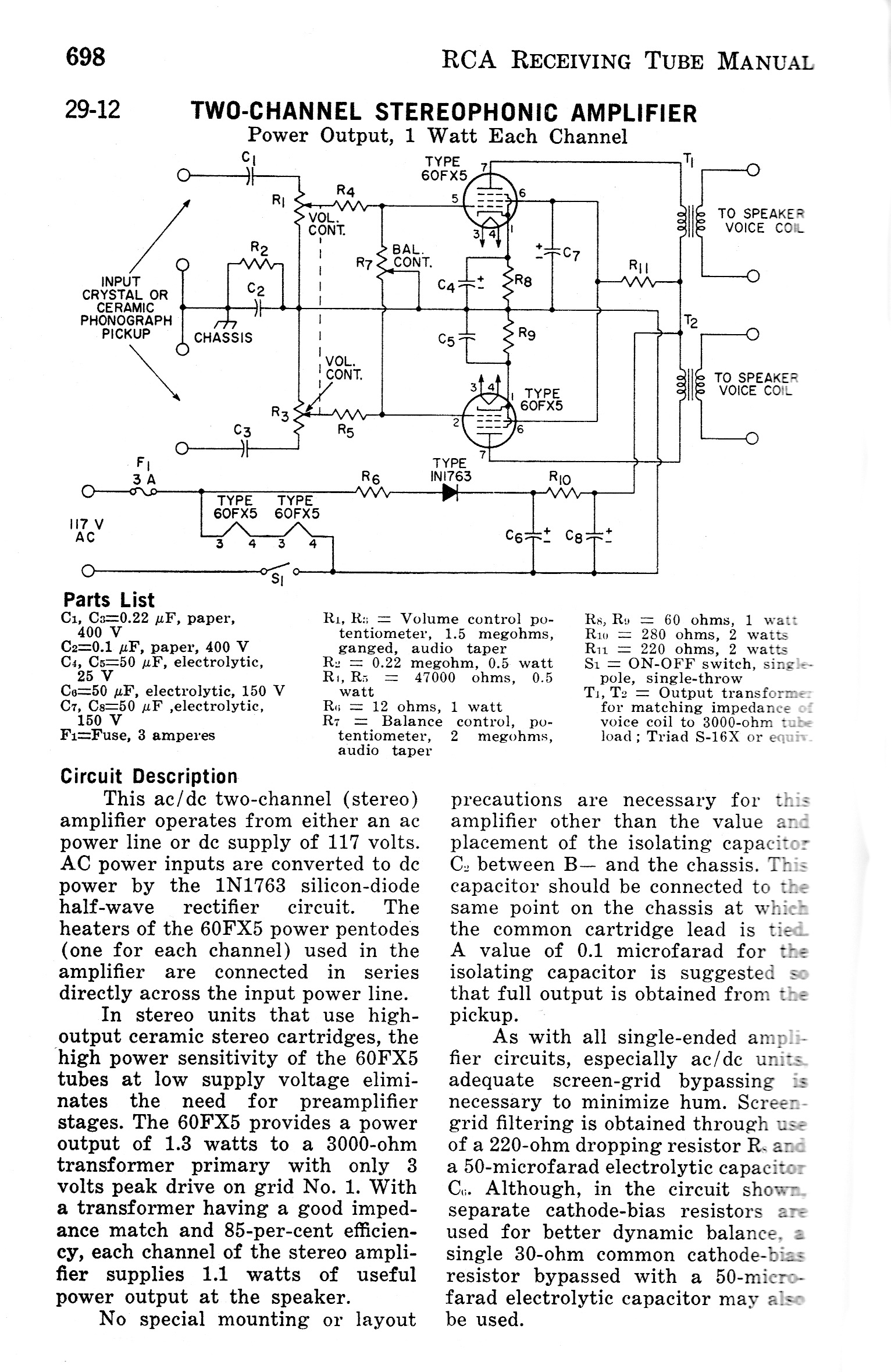

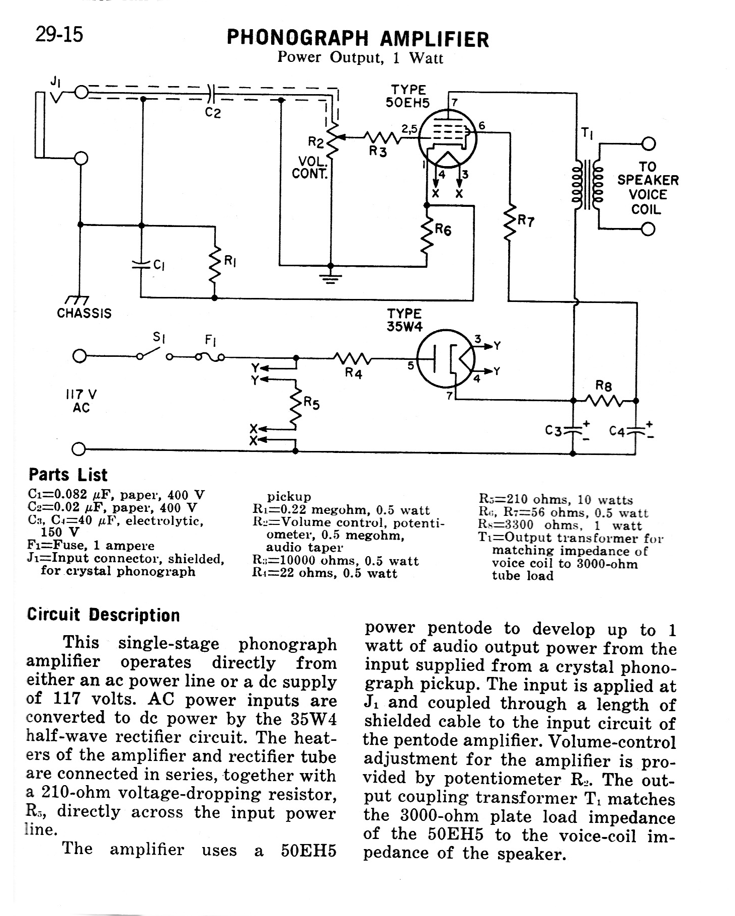

Here are two more transformer-less designs, this time from the RCA RC-30 Receiving Tube Manual. (1975)
The mono amp uses a 50EH5 and the stereo amp uses a pair of 60FX5's. The recommended output transformer for both is a Triad S-16X. (3000 ohm to voice coil) Just looking online for these, I'm starting to think transformer-less output would be much easier on the budget...
Either one of these might be a fun project.

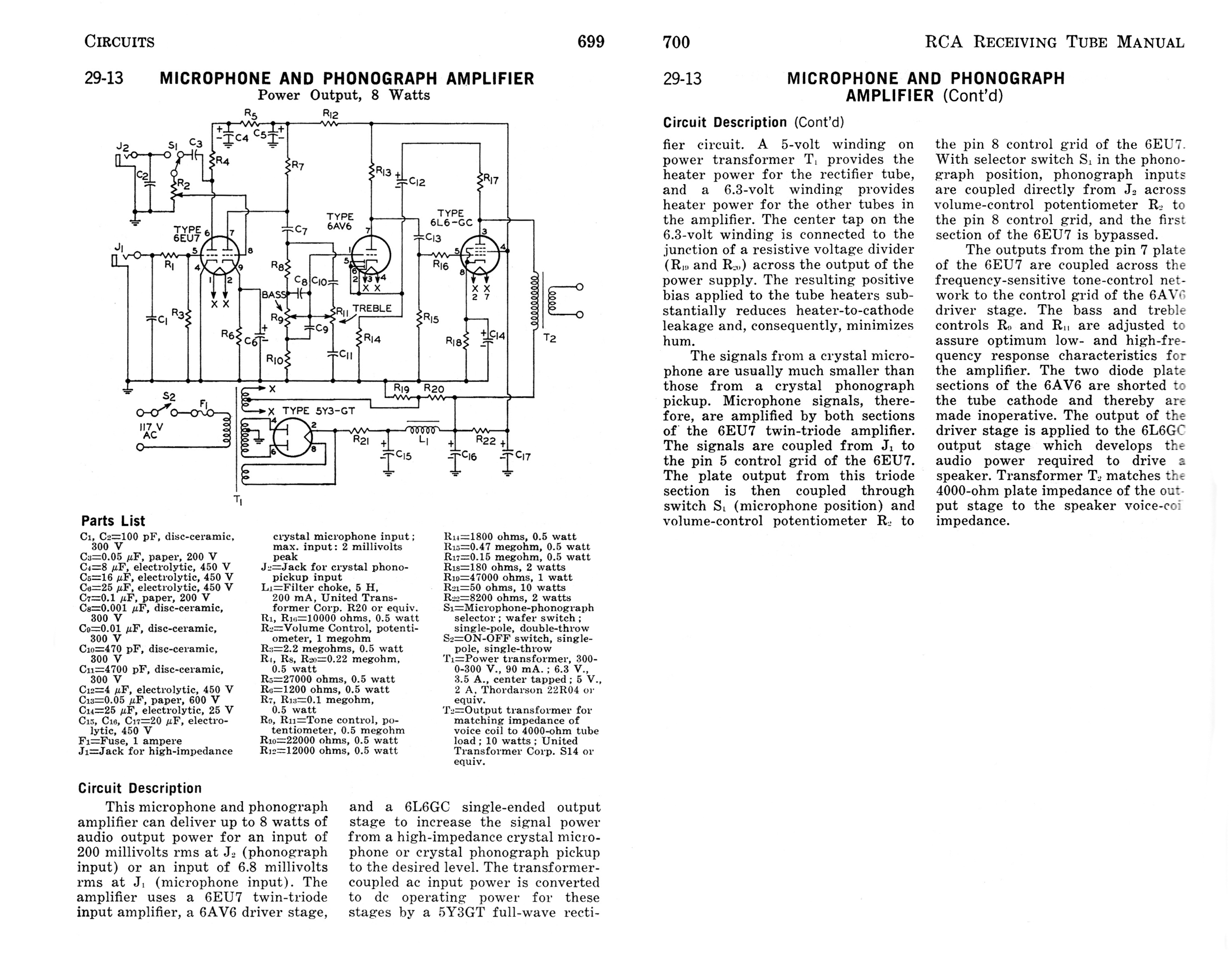

(There is also a nice 8 Watt, 6EU7-6AV6-6L6-5Y3, schematic in the same manual, but it needs transformers at both ends and a Gibson ES-335 to plug into the microphone input!)

Those circuits are in the back of the RCA tube manual. I built the 8W amp for 1st year college electronic lab class project. The teacher ran the amp through several tests he said it is one of the best circuits he ever saw it checked out excellent on the scope. I got A+ on the project. I think the 8w amp will be more useful and more fun than the 2W amp.
