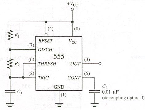

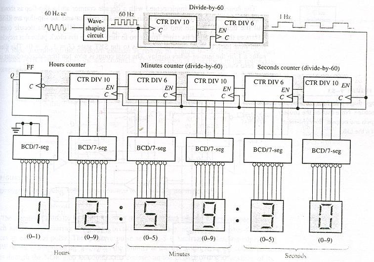

hi
i just wanna ask about something in the 555 timer... i have a school project which is about a digital clock.. i'm attaching a very simplified out line of the circuits.. i'm not attaching the details... anyway the problem is in the 555 timer ...i think it's not working properly so i just wanna know how to check it & to know if it working or not without using the oscilliscope...
i hope u can help me.

I did not see the attachment - could you repost it?
Anyway, my first suggestion is to check the reset input (Pin 4); you may be resetting your timer.
In addition, if you can post all the pin-connections, I'd know if if the wrong thing was connected in the wrong spot.

For the 555 timer, I assume you have R1, R2 and C1 handy. Connect just the 555 timer as shown in your first attachment, and observe the output on the oscilloscope.
The total period of the 555 output is found with this formula:
T = 0.693 x [R(1) + 2R(2)] x C(1)
Calculate your expected period, and compare with your measured period. Doing so should determine if the 555 timer is working as expected.

i calculated R1 & R2 from this relation before and i'm using 10Kohm & 2.2Kohm resistors and a 100 micro farad capacitor..is there a range or something for these values ???
Is't there any other possible way for checking except the oscilloscope??
I'm using a breadboard by the way.
Remember? He doesn't have an oscilloscope!
Let's hope that the value of R1 is small with respect to R2. If not, for now, make the value of R1 1K ohm and the value of R2 somewhere around 47K ohms. The output should then be close to a square wave. If the value of R1 is already small compared to that of R2, leave the circuit as is.
Connect a 150 ohm resistor in series with the anode of a common LED. With your 555 circuit running, ground the cathode (flat side) of the LED and connect the other end of the 150 ohm resistor to the +5v supply and note the LED brightness. Now connect the resistor to the output (pin 3) of the 555. If the 555 is working properly, the LED will still glow, but the brightness should be dimmer.
When folks see a digital clock, they tend to expect some accuracy. By trading out the original 60 Hz source (it was from the line voltage, I'm sure) and the other two counters with the 555, you've seriously affected the accuracy of the clock and you'll be chasing the time all over the place. You'll notice error creeping in each day if not each hour.
The orignal 60 Hz was probably a sample taken fron the secondary of the power transformer. If you're using a wall wart or other power supply, you may not have a secondary from which to tap. So, you're stuck with the 555 at this point. But if you want accuracy without the line frequency sample, then you could make a simple crystal oscillator driving the appropriate counter chain to give you your 1 pps output to drive the seconds counter.

I believe the minimun for R1 is 1k Ohms, and that R1 + R2 should not exceed 6.6 Megaohms. I am not sure about the 555's maximum limitations for a capacitor, but I think using such high capacitors may generate leakage current ... though I doubt it will be a serious problem for your experiment.
(This might seem silly, but did you try connecting the capacitor with the short side to ground? If so, can you switch this?)
I believe the best way to test the output of a timer without the scope is by using an LED (and 100-300 Ohm resistor).
