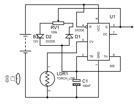

im looking for help with regards to the switching of a 2n3055 transistor,
the scenario we sitting with is that we have a PWM (pulse width modulator) that varies the pulse width at the output (pin 3) of the 555 timer, now we need to use that modulated signal to switch a light bulb which has a 60W rating at 12Volts, this means we need 5A into the bulb...
can anybody help with the circuit diagram from the 555timer to the bulb

okay i have attatched the circuit diagram of the PWM that i want to use...
and if i am not mistaken the logic output level at pin3 should be 5volts

If you look at this 555 PWM circuit you will notice it is pretty much as your circuit. Pretty common 555 type PWM design. Note the MOSFET used to drive the load. Note the output is taken off pin 7 but that is just a design variation. This link provides examples of logic level mosfets. The 2987 would suite your needs or just use the circuit linked to. The IRFZ46N would handle your load. Your circuit runs on 12 volts so I would just use the IRFZ46N. For what you want to do it isn't all that critical.

Just to clarify the reasons for not using a 2N3055 bipolar transistor for this application:
One is that it is rather slow to turn on and off, so the efficiency in a PWM circuit may suffer.
Two, it requires a lot of base current to fully turn on (at least 1/10th of the maximum collector current or in this case 500mA) which would require an additional buffer driver and further reduces efficiency.
Use an NFET or a NPN Darlington.
A NPN darlington at DC 5A will dissipate 1v (5W) which is a bit nasty. Definitely go for the FET.
Also your 555 schematic needs a resistor between pin 3 and pot wiper, to reduce the peak current in/out of pin3 at extreme duty cycles. A 470 ohm resistor will work fine.

You cannot select a Mosfet since you don't know how much gate voltage it will get from the 555 since your schematic has no supply voltage shown.
An incandescent light bulb is almost a dead short when it is cold. Make sure your Mosfet can supply enough current to heat it when its resistance increases to its operating power.

I saw it as BT1 = 12 volts? The text is a little obscure with a diode in there. That was VCC or did I miss something here?

A 100 watt 120 volt bulb draws something like 12 to 13 amps of inrush current but within about 13 mSec. it is hot and down to about 0.8 amp. Not to say 13 mSec is not enough time to destroy a component but for the planned application I don't see the inrush current as a major player.

The transistor may come out of saturation and limit the current during the bulb turn on. But as Ron noted, this is for a short period of time and likely will not harm the transistor.
