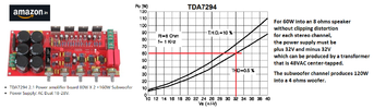

Stereo 30w each channel. 4 ICs on PC board with 2 speaker connections, how does that work? 15w each IC ??? No circuit drawing. No instructions either. Not much to build, only a few wires & PS required. A lot of people probably like projects with not much work. Building a case for the amp with knobs is probably more of a challenge than a PS transformer. Instructions are on the PC board.
I found your amplifier in Amazon on the other side of the world (.in).
It is stereo (one IC for left and one IC for right) plus a mono sub-woofer two ICs in parallel to drive a mono 4 ohms woofer).
The transformer MUST have a centertap.
If the amplifier heatsinks are large enough it can drive 4 ohms stereo speakers and a 2 ohms woofer with almost double the power.
