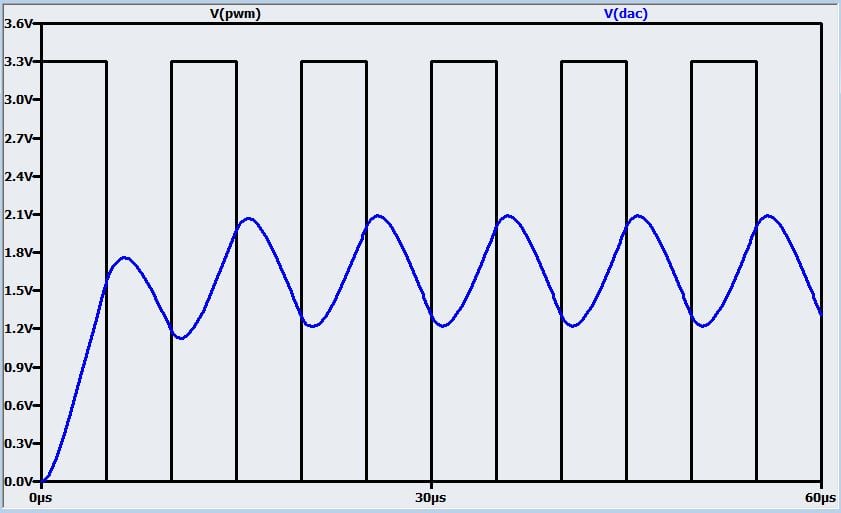

Re. the filter - during each PWM cycle, the series resistor partly charges the cap while power is on, then partly discharges it while power is off (and the lamps are pulling the voltage down).
The result is something like this, with the voltage jittering around the average on/off ratio.
The amount of jitter depends on the frequency and R C values.
(Ignore the voltage and time, that's actually for a high frequency logic signal - but the effect is the same).
