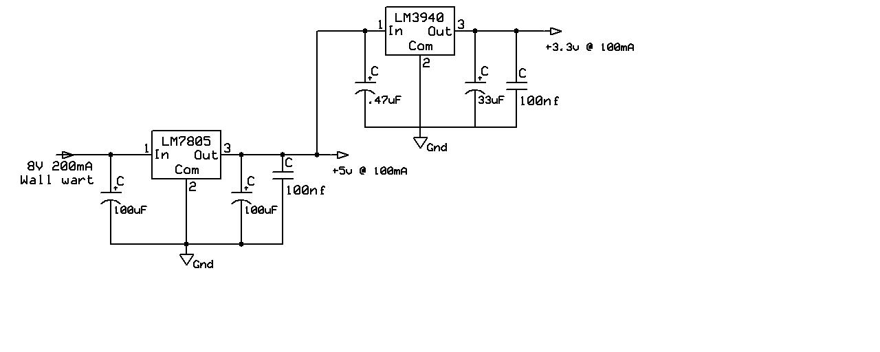

I am trying to design a regulated power supply to feed both a 3.3v PIC and a 5v LCD. Is the circuit below overkill? Is there a better way to handle this?

I suggest you connect both regulators to the 8V input, rather than cascading them.

You might be able to get away with just a 78L05 and if it's a low current, an LED as a crude voltage dropper. Choose whichever colour drops the best voltage.
The LCD requires 3 mA for logic and 120 mA for the backlight.
The max the PIC can handle is 250 mA.
If I get this correctly, the circuit would feed through the LM78L05 producing a regulated 5v. Then I would connect a LED with a forward voltage of 1.7 in series to the PIC, which would produce the 3.3 needed to power the PIC.

If the PIC takes 250 mA you'd need a Luxeon Star high power LED. Then it might look a bit silly, and the light would hurt your eyes when you are testing the PCB. Maybe a 317 is a better idea.
Is the 3 V PIC driving a PWM and a MOSFET? Wow!, all off of 3V?, that's a clever design, how did you do it?
Choose a wall wart at least double the current it'll be supplying, they are not expensive. You could pick a 5 V regulated one and delete your 5V regulator.

Feed the PIC the required voltage (3.3V) and it will only draw the current it needs. The amount of current it will draw depends on it's clock speed, how many peripherals are enabled, how much current it's IO pins is sourcing, etc. There is a chart in the datasheet which show the typical current draw at different clock speeds. See table 26-4 on page 225 of the datasheet.
There is nothing wrong with cascading the two regulators as you originally posted. In fact, the LM3940 has a max input voltage of 7.5V so that would be required if you were feeding them with an 8V supply. As mentioned, a 5V regulated wallwart is a good option too.
As for the FETs, yes that was my hope. Four channels each feeding a logic FET with 3.3v.
Yes, you can get FETs which work with 3.3V devices. For example, the Si4466DY has an RDS(on) of 0.013Ω at a Vgs of 2.5V.
