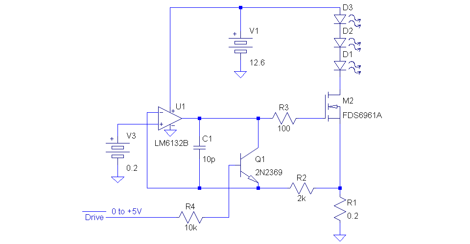

I want to make a strobe out of a series string of 3x 3.9V, 1 amp Luxeon emitters, powered by a 12.6 car battery, which of course can go up to 14V or so. I will be flashing it with another one of my microcontrollers, probably at 5V again.
12.6V- 3*3.9V = 0.9V to control the regulation.
Since there's not a lot of voltage room here, the currents are high, and the pulses will be sharp which makes feedback tricky, I figured just an NPN and an emitter resistor would do it.
So I think shooting for 0.3 Vcesat would mean a maximum of 0.6 ohm for the emitter resistor.
I don't know if this is such a good idea, I now need a fairly tightly regulated voltage of 1.2V, depending on gain might be 3 to 10 mA. And it has to switch on and off really fast.
Any good way to do this? Or should I think about using an op amp to drive the NPN (or MOSFET) and use the voltage on the resistor as feedback to the op amp?

I've already slept on it and the obvious thing to do is a N-channel MOSFET and a TL082 op amp. The 5v pin goes into a resistive divider to get 0.6V, goes to the noninverting input, the voltage on the 0.6 ohm source resistor goes to the inverting input, and the output to the gate. I hope it's not going to oscillate.

This switches pretty fast in simulation - about 400ns turn-on delay, 100ns turn-off delay, and LED current rise and fall times of about 100ns I sim'ed with a battery for vref, but you can use a voltage divider from whatever gives you the stability you need. I lowered vref to 200mv so I could use a smaller MOSFET. You can substitute 2N3904 for 2N2369, but the turn-on delay of the LEDs will go up to a couple of microseconds due to storage time in the 2N3904 (2N2369 is a high-speed switch).
