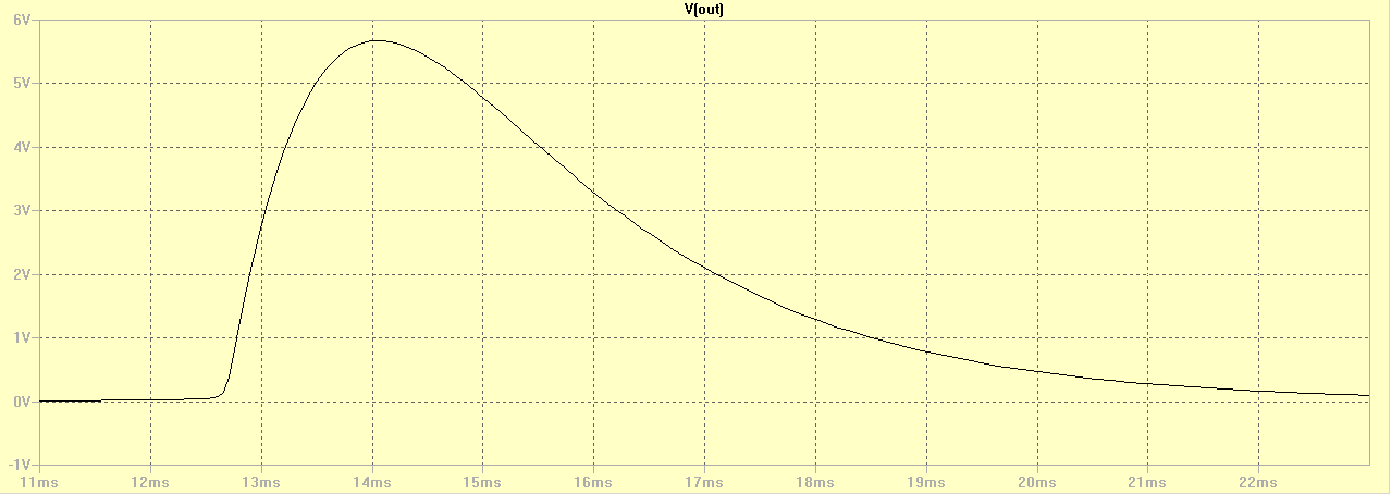

I think this circuit might work; I simulated it (in LTspice), and it generates a ~1mS pulse, about 5 volts, about 12mS after power-on. You could probably tweak it to get closer to your specified timings.
So can anyone here tell us how to improve this? It doesn't exactly produce a square wave. What's the easiest way to square up the output? make sure the transistor is driven into saturation? (LTspice file attached below.)
Well, that aside, am I on the right track here? Can anyone come up with a simpler solution? (For my money, I'd like to see something without an IC like a 555. This is such a simple function that it seems to only need BJTs and such.)

One way is to add a second transistor and invert the action of the first transistor.
So you'd, what, make Q1 an emitter follower and Q2 a common-emitter stage?
By the way, here's the trace I get from this circuit (somewhat modified, new LTspice file attached). Not too bad. A little wider than 1mS, but should be fine to trigger a camera with, I'd think.

A few milliamps will do. It is going to trigger a camera in the shutter release socket. I haven't measure how much current it needs yet.
I may be way off base with this, and if yes, I am sorry for questioning. I have a few DSLR cameras a Canon EOS 10D and a 7D. Both of these cameras as well as many other DSLR cameras I have worked with involve using a logic low signal for external or remote shutter release. The shutter release on my own cameras has a 3 pin connector. Two of the 3 pins are held at a logic high of 3.3 volts. They are held high through an internal pull up resistor. Placing either pin to logic low will fire a function. One pin is the AF (if used) and the other is shutter release. I just want you to be sure that an external positive pulse of 5 volts is what you want.
Ron
Well, if that's true, my simple circuit could certainly be tweaked to produce a negative-going pulse. But it's a good question.
