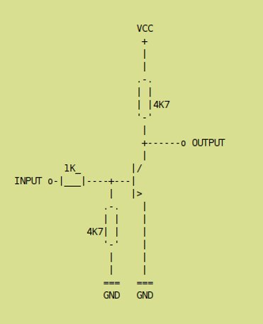

i wonder if you can help ? is there a simple circuit ( other than perhaps a relay) that when you send 5v into the circuit an LED is turned off and when the 5v is reduced to 0v the LED instead lights up : )
i have a fair few LEDs to turn off and on individually like this so am hoping to keep the current consumption as low as possible.

An inverter is needed that can drive the LED. A common-emitter transistor or a logic inverter.

i managed to get this circuit to work below.... on my test table i used a 5.7volt psu as the input and a 10v psu as the VCC. all my leds are 5v type. Wow i forgot the 1k resistor to begin with on the input, the transistor became very hot when i applied power. owch. after i added the resistor it was fine.
Also changing the resistor value from the VCC to the collector i could up the volts/amps to turnoff/trigger a relay too. :)
i make sure the transistors and resistors are cool or warm to the touch when i make a change from now on. ( although a more advanced knowledge of electronics and multimeter usage would be more ideal perhaps, lol : P
i used a 2n2222 npn type transistor.

I was thinking NOT Inverter, by far easier that most of the things people have been suggesting,
When input is high (5V) then output is low (0V) and the LED is off
When input is low (0V) then output is high (5V) and the LED is on
EDIT: Someone posted a Transistor NOT Schematic above
