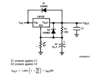

For all but the LM117, something around 120 ohms is recommended for R1.
edit: also, C2 is what they meant by "bypass the adjust pin"
