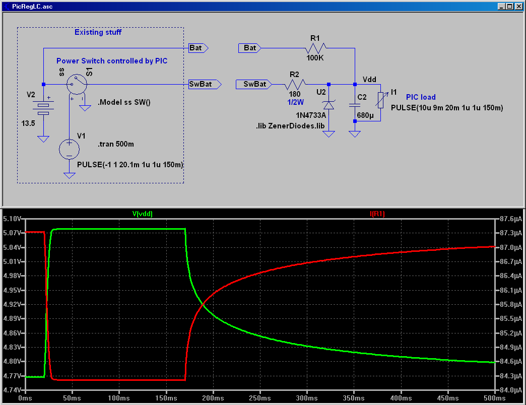

Based on Colin's input, here is what I came up with:
As long as the zener maintains a voltage above the minimum operating voltage of the PIC at the low bias current, then that should work also.
A zener does not "turn on" until the zener voltage is reached. But the actual zener voltage can be a margin below the marked value and the zener will "leak" when this lower value is reached and continue to "leak more" as the voltage rises - to a point where it "leaks considerably" when the rated voltage is reached. For a 5v6, this lower voltage can be as low as 4.7v. When a zener is supplied with a very low current this leakage will be noticeable and it will appear that the zener is only working at 4.7v. As the available current is increased, the voltage across the zener will increase. This is because the leakage current creates a lower voltage-drop across the "current limiting resistor."

Thanks Eric. Before I used the simple Zener circuit suggest by Colin, I Spiced a series regulator based on the TL431. It was simpler than yours, it took advantage of not needing a low drop-out voltage, and it used a series NFet with the TL431 shunting the gate of the FET to ground. I biased the TL431 so that it had much less than the minimum 1mA specified on the data sheet. It simed ok, and had low quiescent current, but when breadboarding it, it didn't regulate any better than the simpler Zener version, and used a lot more parts...
