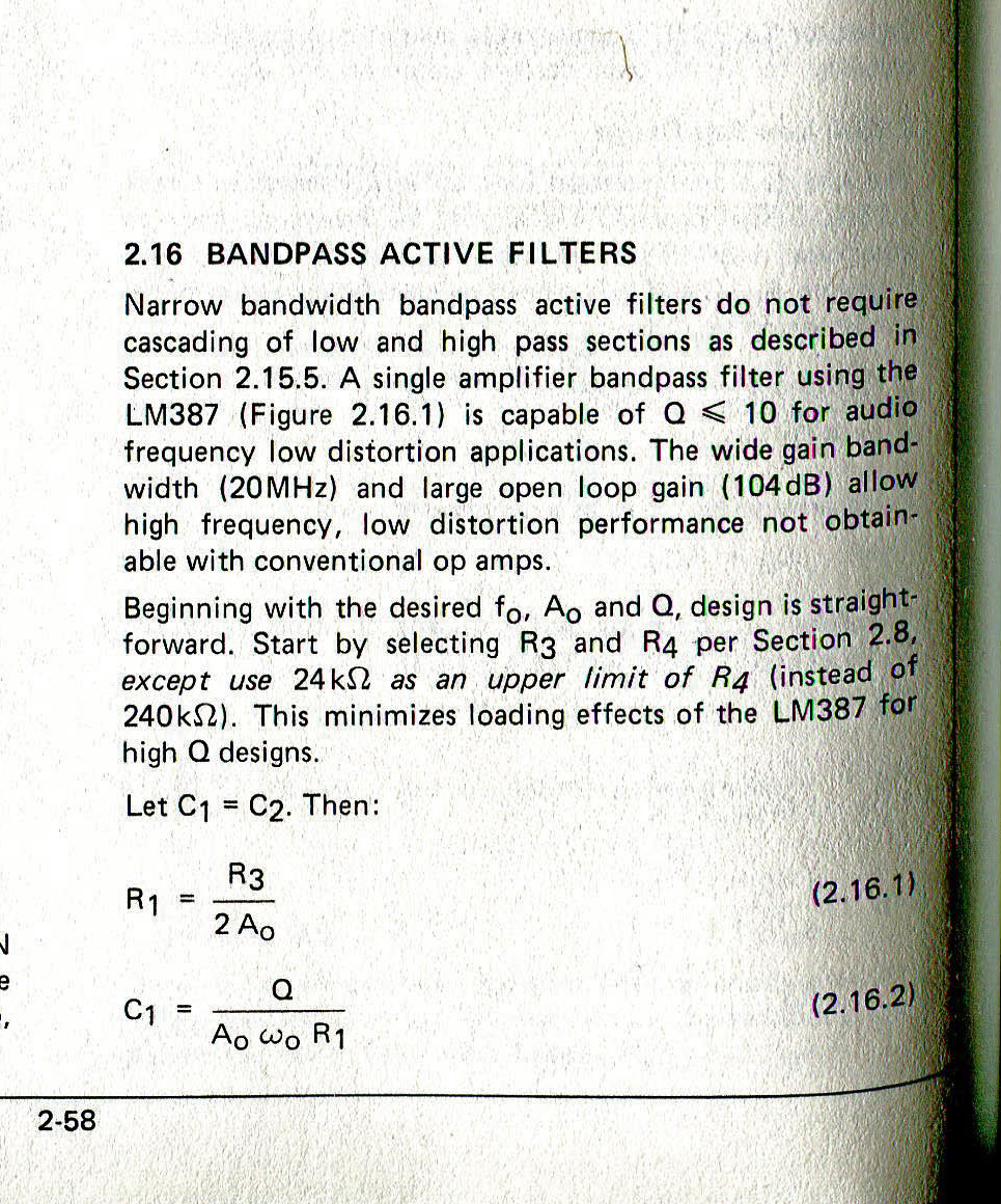

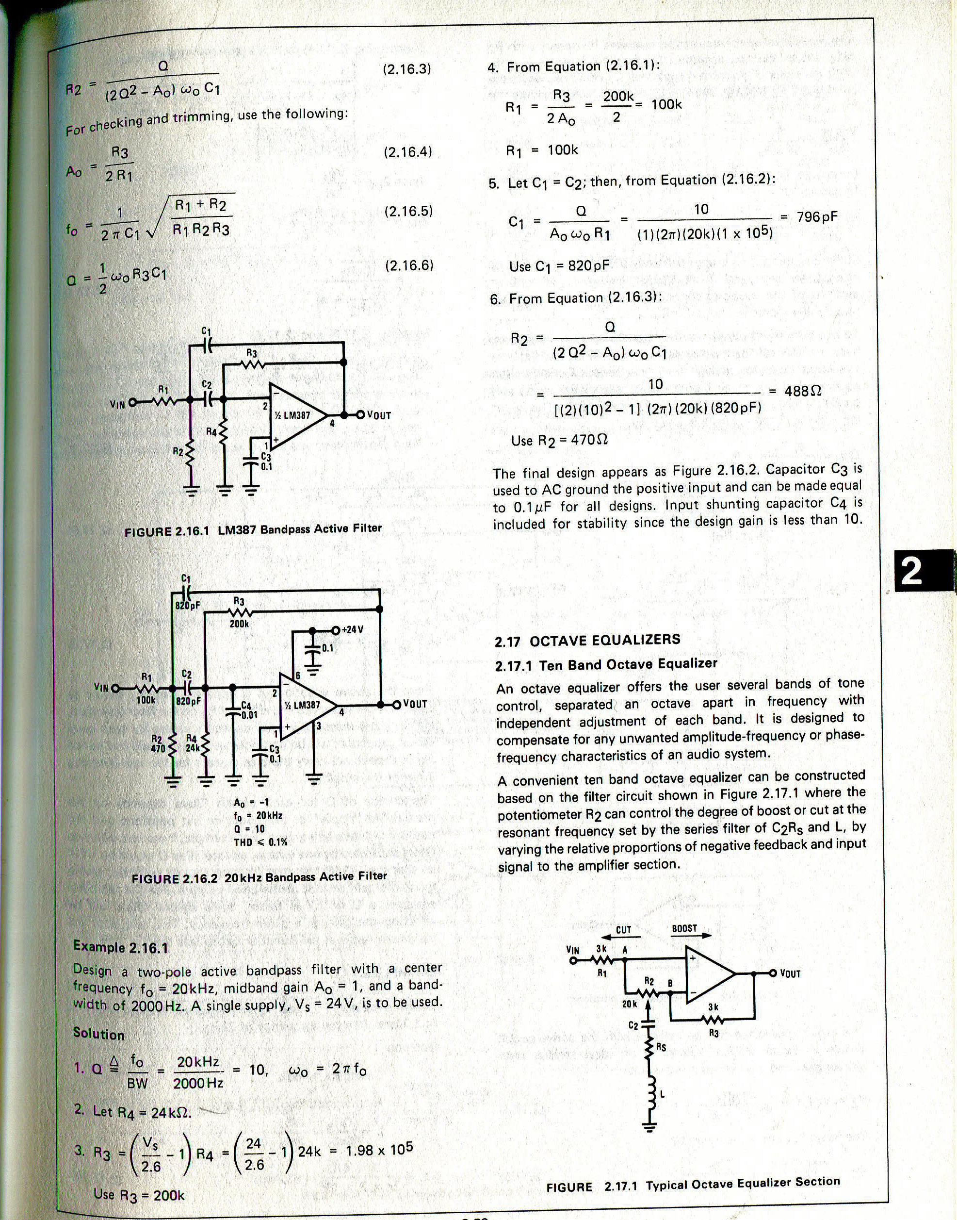

I researched it back to the book I used to design the bandpass filters. If you want the filters to have a wider passband, it means lowering the "peaking" of the filter which is termed "Q" in the design equations. I copied the sections of the book related to the bandpass filter and attached them. Follow the equations and they should work. You don't have to use an LM387 op amp, I used LF356 and TL084 FET op amps. Any good bandwidth op amp should work.

Well all that value selection stuff seemed a bit too involved for me since I didnt understand what half of the symbols stood for and I didnt really know what I should set the bandwidth at since it is a logarithmic scale. However I did find **broken link removed**, which I should just be able to use the first half of and use the output of each filter seperately. However since this circuit is obviously designed with high output quality in mind which I really dont need, could someone help me trim it down to make it a bit simpler.
The document also has useful information on the calculation of the values and puts it in a simpler way than the various other documents I have found.

The bandpass filters shown using a single op-amp per band are as simple as it gets for a bandpass filter.
If you know the center frequencies (Fo) you are going for on each filter (you listed them above) just set the bandwidth of each so it goes about 1/2 way to the next higher filter center frequency (Fo).
