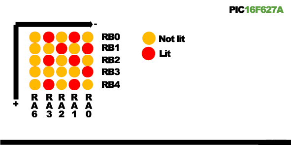

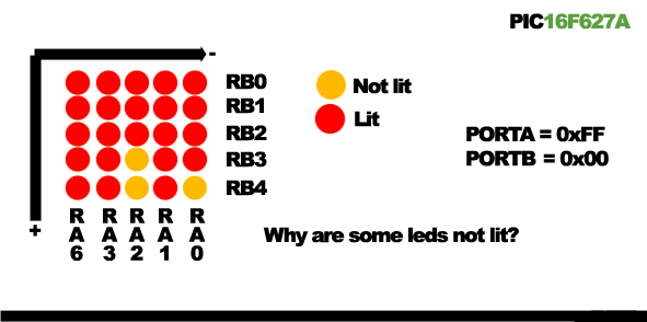

Im trying to make a 5x5 led matrix display, similar to the one found **broken link removed**
ive wired up the leds in rows and columns.
All the leds anodes in a column are wired up,
all the cathodes of leds in a row are wired up in series with a resistor.
Im utilising PortA ports 0,1,2,3,6 for the columns
and PortB ports 0,1,2,3,4 for the rows.
When i set PortA to 0xFF and portB to 0x00, most of the lights come on, appart from 3/25:mad:
Please consult picture.
I have checked the wiring on the LEDS and it all appears fine,
and obviously the wiring must be fine connecting the ports to the columns/rows as some leds on the row/column in question work.
Does anyone have any idea whats going on?

The LEDs that are not lit probably have a higher on voltage than the rest. In effect, what you have is 5 sets of 5 LEDs in parallel. Try turning on one row at a time by just setting 1 bit of porta.

First check the matrix with a multimeter whether the LED’s working one by one by placing mulimeter probes to RA & RB ports after removing the PIC.
If so use this AGAIN routine in your program to check all the LED’s. No delay added in this part just to check all LED’s lit.

The circuit is designed for multiplexing, you need to do as Pommie has shown so that only a row at a time can be lit for a short time to reduce the average current through the ports.
If you don't do that, then you will exceed the individual port pin current limits (25mA) or the total ports limit (200mA).

I get a checker board, but the same leds will not work.
see pic for illuminated leds.
many thanks
In your both attachments I see different LED’s LIT & NOT LIT.
In Picxie's method he is driving columns NOT through transistors directly from a PIC pin.So the code must be inverted.
Better you attach a diagram of matrix arrangement.
Sorry all.
Im a fool:eek:.
When I was checking the wiring last night(2.30 this morning!), i must have overlooked a broken trace or two!
Ive just checked the wiring again, and this time i found two broken traces, and hence bridged them with some wire.
All is now well!
Many thanks everyone.:)
