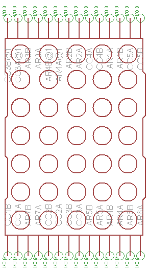

Since i had to make my own Eagle drawing would you say this is accurate?
led1145-png.23667
matrix-png.23665
Anyone know how to move the text on the Symbol?
Of course i have to move the pins down some so it matches my datasheet.
OK I now have a eagle part made for it :D fits nice too! I tried it on paper and a foam back and pressed it into the paper.
