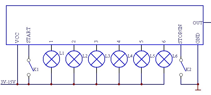

i have no idea about electronics. I purchased the item to control lights (off/on delay) the 6 ch will control 32 lights (6 div 32=5 light clusters).
What I need to no.
Power pack size (v)
How to wire the lights
How to wire the power pack.

1. Use one module:
K2 disconnected, K1 closed, L1-L6 lights up one after one, and at last L1-L6 stay on lit-up status.
If K1 disconnected, L1-L6 all go off.
If K2 closed, no matter K1 at what status, L1-L6 will not light up.

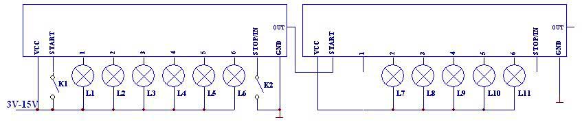

2. Use multiple modules in series:
K2 disconnected, K1 closed, L1-L11 light up one after one, and at last all stay at lit-up status.
If K1 disconnect, L1-L11 all go off.
If K2 closed, no matter what status K1 is, L1-L11 will not light up.
