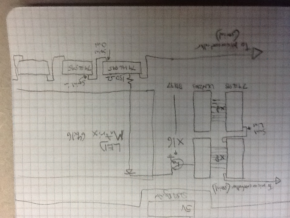

I am trying to build a pinball machine, and the design of the LED display is giving me grief.
I plan on mounting 1024 LEDs in an acrylic sheet in a 64x16 array, and using 8 595s to drive the columns and 2 595s to drive the rows. My problem is I need to find a good power transistor/MOSFET to drive the rows, as each LED used 20 mA, for a total of 1.28 A. I had been thinking of using 16 SI2312BDS, but I would really prefer not using SMT. I will be using a chipkit to drive the system.
Any recommendations for the transistor or any other part of the display would be very helpful.

Okay, I drew these paper schematics of the control setup (just to see if I was arranging things properly)
2013-03-17 15.50.29.jpg this is the row driver setup
2013-03-17 15.50.36.jpg this is the column resistor with a single LED
Do these look right? Thanks for all the help!
Yes, what you've drawn would be correct except that the the ULN2803 can't handle 1.2A which is why WTP suggested using a BD137 on its output. Sorry, I missed that in his post. Also, you might want a buffer on the column driver as the shift register won't necessarily be able to supply 20mA to all of its outputs at once (you might also like to increase the 20mA as each row is only driven for 1/16 of the time).
My suggestion is to use either a discrete MOSFET on each column and row, or MOSFET arrays.
Okay, so I use a MOSFET to boost the current (Fairchild has the BD13716S that can handle 1.5A)

Does this look correct? I have the BD137's base attached to the output of the ULN2803, the collector to the matrix, and the emitter to the ground.
The display will be driven by a propeller or more likely a chipkit, so I'm confident that I can send the serial data fast enough for all 64 outputs.
No, it won't work as BD137 is NPN and the ULN2803 output is open collector.
Just use a mosfet on each output of the '595.
I thought that the BD137 was the mosfet, should I choose a different one?
I know the base goes to the 2803, should the collector or the emitter be connected to the ground?

If you're using a N-channel MOSFET, then you don't need the uln2803. You also won't be connecting to the base, collector or emitter, but instead the gate, drain and source. The gate connects to the '595 output, the source to ground and the drain to the cathode of the leds.
Would the NTD5867NL (through hole) work? The gate threshold voltage is a max of 2.5v.
I'm assuming that it means that at most it takes 2.5 volts to make the mosfet allow current between source and drain, is that correct?
Okay, so the cathodes of the LEDs are connected to the mosfets, which are connected to the ground, and the anodes are connected through the resistors to the 8 shift registers that provide power.
The mosfets are connected to the two shift registers driving the columns, and both sets of shift registers go to a chipkit.
Thanks for taking the time to explain this, I'm relatively new to all this (plus learning about conventional vs. actual current when I was young messed up my thought process). All of these light bulbs are going off in my head, and all of the crazy numbers on the datasheets now make sense. :D
Sounds good to me. The two sets of shift registers can be connected as a single string of shift registers as you'll need to update all registers for each column drive subcycle.
Conventional current makes more sense when reading schematics due to the direction that the arrows are drawn in the symbols. It also seems more obvious that the current is flowing from a higher potential to a lower potential.
Oh, that makes sense, then the row mosfet will turn on as all of the columns do, so the sign syncs up automatically
