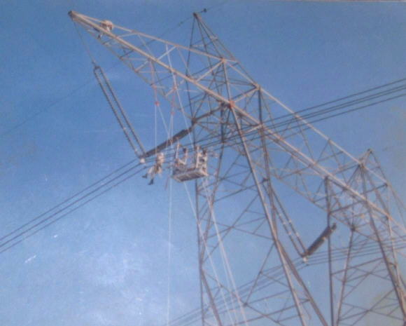

Here is a Picture I took a number of years ago of guys doing Energized work at "Ontario Hydro" in "Canada" This is on a line at "750 KV" and the Guys are Wearing Metalized Conductive Suits.
They are using an Insulator Tester that I designed and Built.
Gary

WOW !!!

I know it as a Faraday suit - 20th century "chain-mail" to prevent any chance of equalising currents flowing through the linesman's body.
