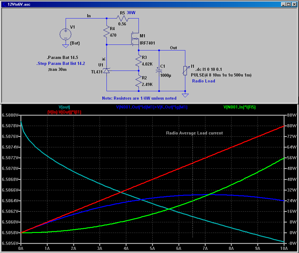

A friend has restored a 51 Chevy, and in the process, converted it to a 14V alternator system. He would like to run the original gas gauge, a 6V heater blower, and the original 6.3V tube/vibrator in-dash radio. All other appliances (lamps, etc) were replaced with 14V equivalents. I am going to build him an LM317 + Power transistor on a heat-sink 14V to 7V voltage reducer for the radio. The other things he will use a wire-wound power resistor.
Any body know how much current the original radio draws? My first car was a '48 Chev, and later I had a '52. Both had a vibrator-powered B+ supply, and 7 or 8 6.3V filament tubes, but I don't remember measuring the current? I'm guessing 5 to 8A.

Thanks, according to the reference posted my MRCecil, it draws 6.5A at 6V. The fuse is 14A.

Here is a hack at it: Using an TL431, a large TO-220 NFET, and a power resistor. Note that the total dissipation is the red trace, split between the FET dissipation (dark blue), and the power resistor dissipation (green trace). The regulation is pretty good (light blue trace). The capacitor improves transient response because part of the load is the vibrator.
I know that a switcher would be way more efficient, but the car has a 60A (800W) alternator, so loosing 50W in the regulator is no big deal.
