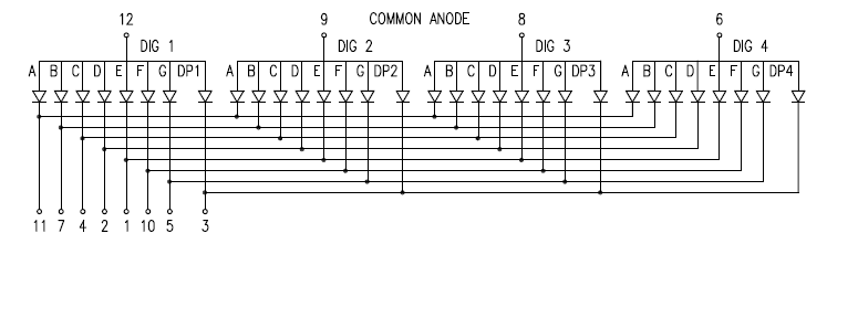

I'm looking at a LDQ-M282RI. It's got decimal points and two center leds for a colon like a regular clock has. Problem is, the datasheet gives no indication as to how the colon LEDs are connected or controlled. Does anyone know how this might work?

I could not find the column pins for this display
total 12PIns-- 8 for segments +dp, and 4 for digit drives.

The colons are treated like any other segment, a separate pin for decimal and one for the colons.

I have a number of 7 segment LED's, you can see the outline of other symbols, eg: colons and + signs but they are not connected.
It appears they use a common mask in production to cover all their types.

Please see the attached part extracted from the datasheet of the display indicated by you. Now we have to expect that either there are 4 DPs one for each character or imagine that there are 2 DPs for first and last digits and two at the centre to emulate Colon.
