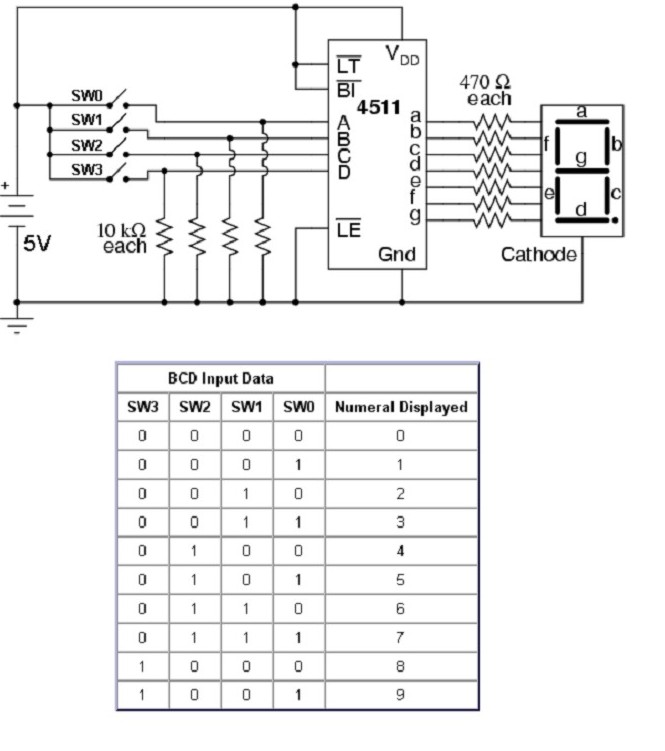

Nearly all logic devices (counters/ displays) are manufactured to count/display from 0- 3 ---> etc. So you will have to use an adder to increment a zero state (on,on) to (on,off) to satisfy a display module. A cmos 4008 will do that.
I also presume that you want to interpret the state of two lines, not a counter, hence you need a binary decoder. All I can see in the cmos is a 4555 that will give an A,B,C,D output.
I can not find a 7 segment display that will give 1,2 3,4 outputs with A,B,C,D inputs. EG 4511 will give A=1 B=2 BUT C=4 and D=8, So you will need to split the C and D outputs with Diodes to make discreet 4511 inputs C= (A+B inputs) and D = (NOT A+B+ C inputs)

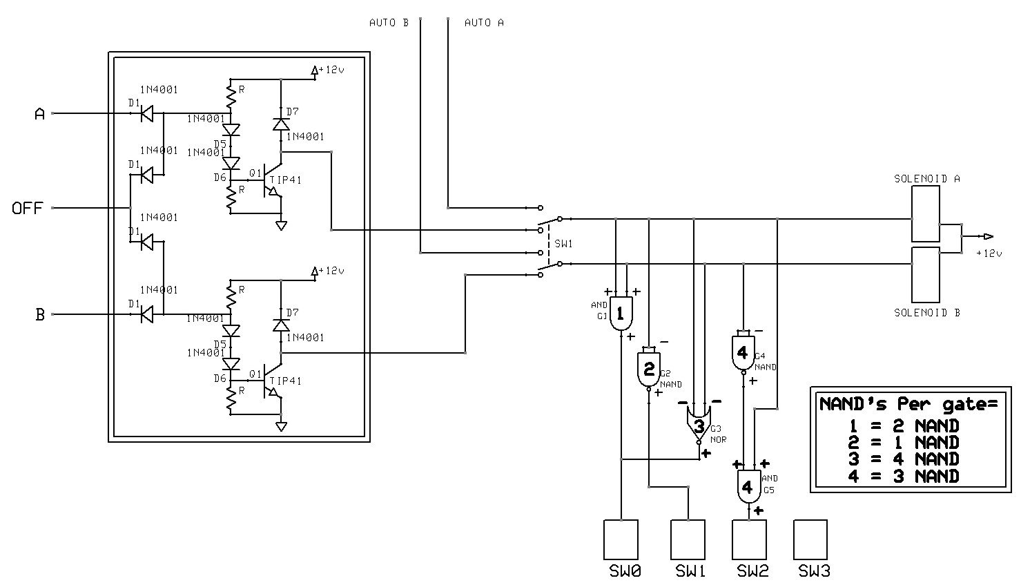

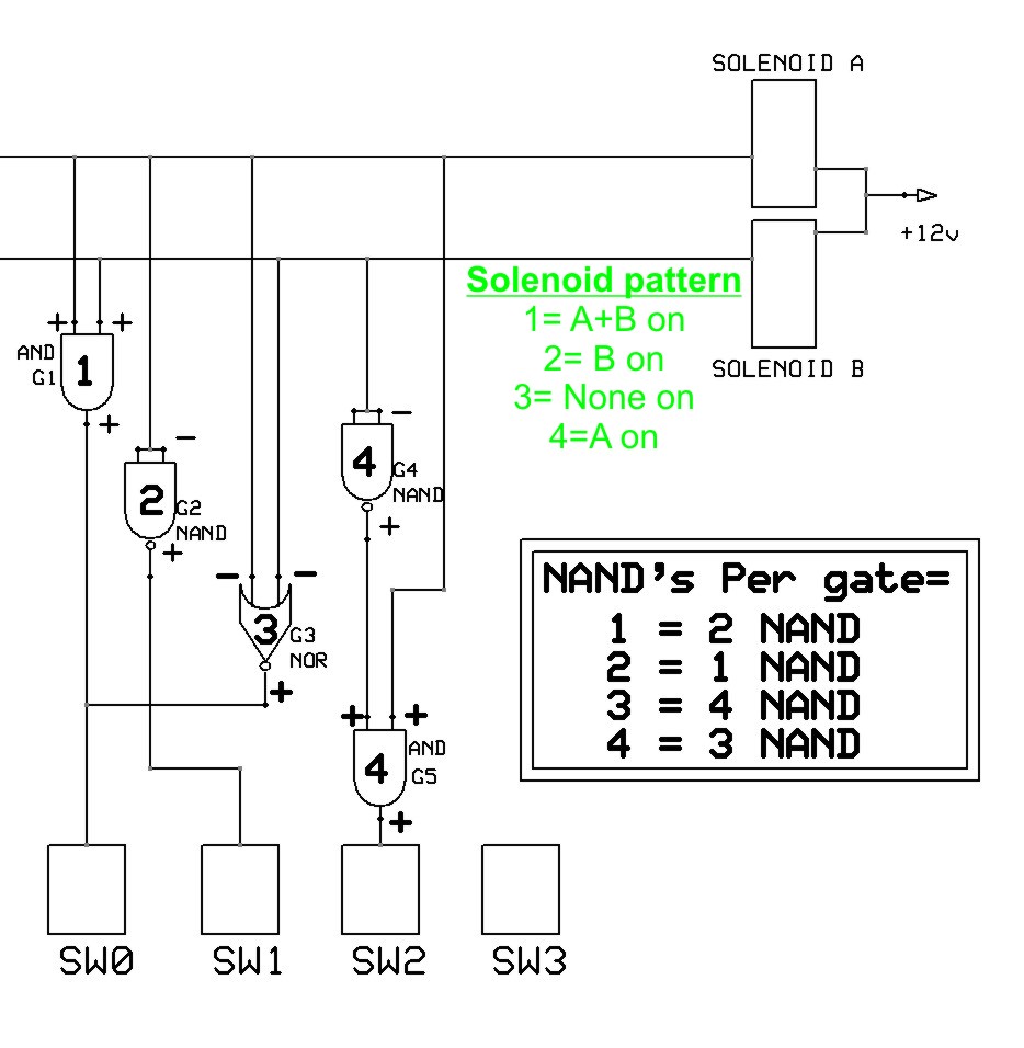

I think I have figured it out after reading a little about gates. Ive attached a section of my diagram with the logic I've come up with. I know this technically wont work because the solenoid signals are ground.....actually, how do you know what polarity works for a gate? Are they always voltage Dependant? More reading I guess. Anyway, I will work some power switching transistors in before the logic if thats what is needed. Is there a single IC with 10 NAND gates available? The switches Ive draw (SW0, SW1, SW2, SW3) correspond with the switches in the second attachment. Would this work?
I'm really trying to learn as much as I can so if I'm way out of the ballpark please let me know or direct me to more information. THANKS AGAIN!!

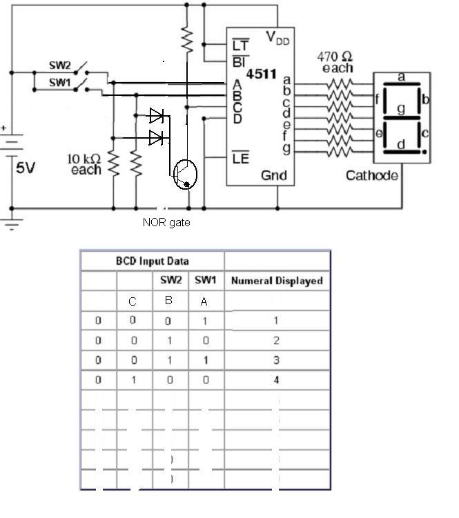

Two inputs, displays 1,2,3,4. I think.:rolleyes:

The simplest (circuit-wise) way to do it is to program a PIC with at least 9 I/O. But if you are not familiar with PIC's then it would take longer to learn than to use old ttl technology. Do you have access to any kind of microcontroller or PLCC?
I can send you some code and a schematic I made that will decode binary to a hex display. It would be fairly easy to modify for your purpose.
On that schematic you tied the outputs of two of the logic gates together. That is not a good idea, it can and probably will kill one or both gates.
Do you have just NAND gates or a mix?
I would love to learn how to do it....what do I need and where can I get information...Ive looked into it a little but there are so many versions of controllers and programmers that I'm not sure where to begin. What do most people use and where can I get info on it?
