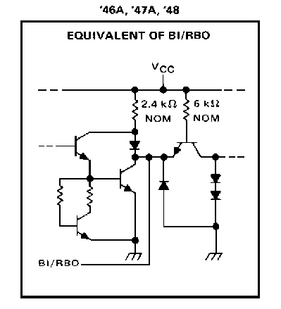

Hi Kadunk,
LT and BI should be connected to +5V.
RBI/BO is an exception, it should be left open because it's
also an output, an open collector output. It should never
be connected directly to +5V.
on1aag.

Good point about -BI/-RBO being left open. It's been a long time since I used that chip.:rolleyes:

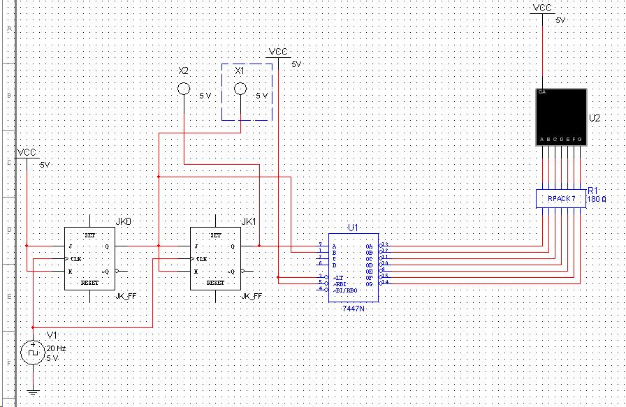

Hi everyone,
I'm trying to make a simple BCD counter, from 0 to 3 only, using the 7447 and JK flip flops, i cant see where the error in the circuit is, as my 7 seg LED display doesn't light, can anyone help me here and check where is the problem in the circuit. I'll attach a pic of the circuit. Thanks
note: X1 and X2 are just probes

bashbash said:
Hi everyone,
my 7 seg LED display doesn't light, note: X1 and X2 are just probes
Just taking a quick glance at your circuit you probably have a blank display because you have all high imputs to the '47.
In TTL, untied pins usually show as high, and if both the A and B inputs are high, as I suspect they are, you will have four highs.
The truth table for the '47 shows a four-high input equals an all high output, which equals no segments lit.
If you are breadboarding, quickly tie the C and D inputs to ground and see what happens.

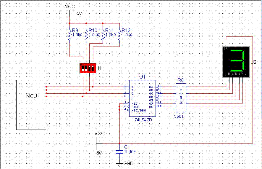

i'm using SN7447A and found 1.6v at the 4 inputs (A,B,C,D), even without any input signal. is that normal?
hmmm.....
i'm interfacing it's input to an MCU. but the MCU cant detect 1.6 as low. i tried pull it low, but when the dip is on (to 5v), the input still detect as grounded.
any way to make the input low (~0v) when dip switch is at off position, and high (~5v) when dip switch at on position?
thanks

I saw on another thread someone saying the 7447 was inproperly coded on some sims, and gave false indications.
Perhaps that is your problem.
