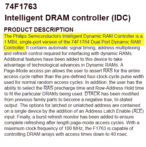

Read the description in the 74F1763 datasheet.
Not the same but close.
