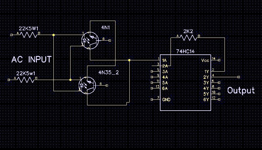

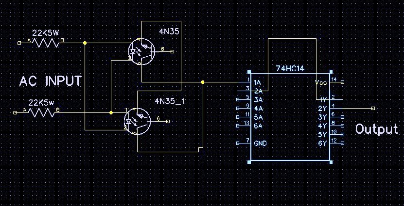

I have two built circuits and I am trying to integrate them. In one ciruit there is 74HC14 IC and there is a 2.2k resister between two gates (pin2 and pin 3) and in other circuit they are directly connected (pin1 and 2). I want to know why is 2.2k resister used? I know the purpose is to invert the output of first gate but why we can't directly connect those pins in both cases?

Sorry for the mistake. I wanted to say pin2 and pin3. The two circuits are x10 transmitter and a x10 receiver. 74HC14 is used to detect the zero crossings of the AC power lines. (x10 is a protocol that is used to communicate over power lines) And I want to combine both transmitter and the receiver together and create a transceicver. In the transmitter ciruit pin2 and pin3 of 74HC14 is directly connected and in the receiver circuit they are connected through a 2.2k resister. I want know the difference inbetween so that I can use either directly connection or the connection through 2.2k resister for my combined transceicver circuit.

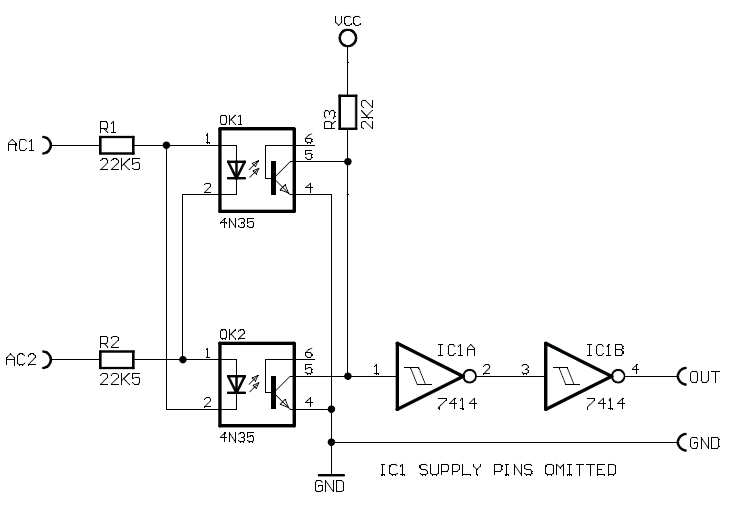

I see one way how the 2.2K resistor could make sense.
Something like that:
With the collectors of the optocouplers connected to VCC and the emitters to ground you'd short the supply source when the optocoupler transistors conduct.
