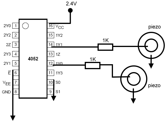

But, post the schematic, otherwise it's impossible to tell what might be wrong. Maybe your 4053 is defect. Have you tried more than one of same type?
The schematic is really simple. I tried several 4052, they all behave the same...

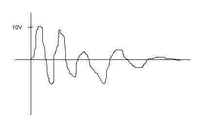

Unfortunately I don't have an oscilloscope, but in theory (and in practice) it looks something like in the figure I attached.

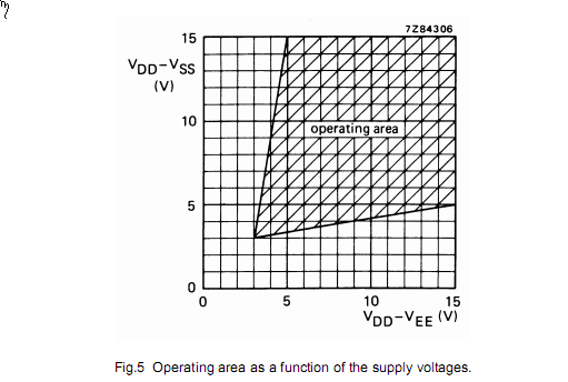

You are operating the 4052 outside its specified range, see image.
You will find that some CMOS devices will work just outside of their specification, others dont.
EDIT:
the amplitude and sense of the analog signal has to be within the range Vdd and 0V

No I'm not. I'm using 74HC4052 which has an operation range starting at 2V. What you described refers to the HCT version of the MUX.

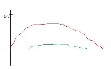

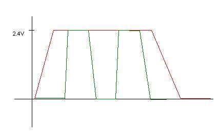

With the ADC I can see when the 'leak thru' appears and with what amplitude. I attached 2 graphics of what it looks like (one showing a hard hit of the piezo and the other a softer hit).
The red signal belongs to the piezo that has been hit and the green signal to the other piezo.

Ok. I've been doing some testing. It seems that if the amplitude of the input signal is lower than Vcc then the MUX functions properly. So I'll have to use a pair of limiting diodes myself...
